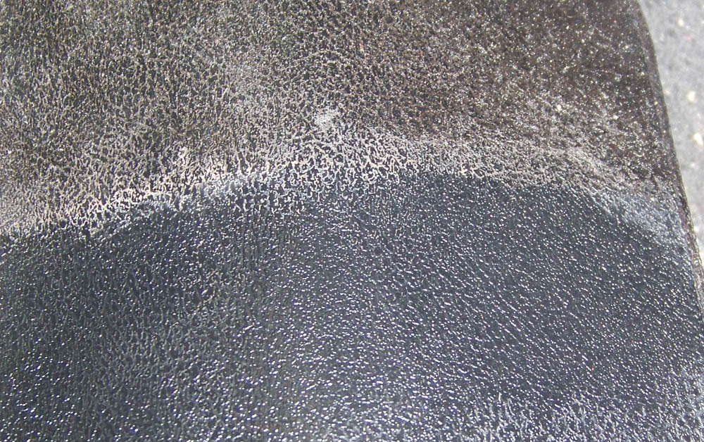

FWIW what is happening is the plasticizers (the additives which make it flexible) are leeching out of the porus material.
Here is a 69 DASH PAD which was so sticky that it would pull lint from a cloth...
Cleaned with denatured alcohol...
~JAG~
