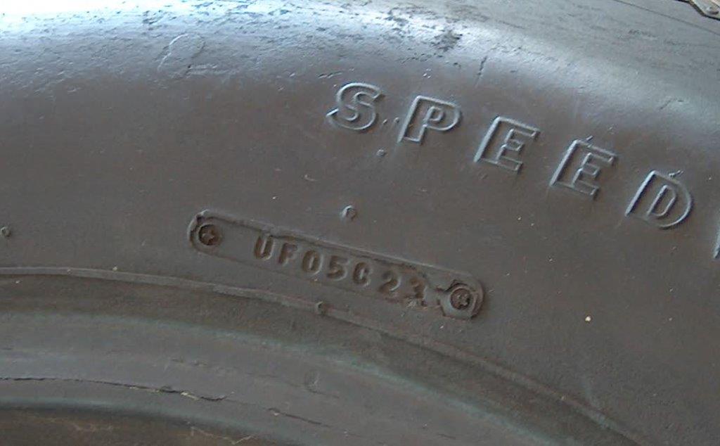

Goodyear Speedway Wide Tread GT
Just making sure this is a repop tire.
CYUYB3EX240 is the date code. Has DOT to the left of that.
Also trying to date a YH ralley wheel. Car is a March Z. Original wheel is in the trunk and I can't read the final digit. It is Feb 2, 21 or 27. Can someone tell me if one or more of those are known good dates. I think it is Feb 2, but my eyes keep wanting to see a second digit in the day code side.

I am pretty sure it is a repop.
Here is a pic of the date code from an original.
Lynn,
Around May of 71 DOT introduced 11 character coding. The last three digits (two for the week and last for year)your example; week= 24th and 0 =year 1980 or 90. In 2000 they went to a 12 digit coding. Two for month and two for year 2211 = 22 week of 2011

Thanks Steve:
So, are you saying Goodyear still made this tire in 1980 or 1990?
What year did Goodyear quit making them? Are the new ones (repops) coded differently?
Thanks for any help.

Thanks Steve:
After the year 2000 they changed to a 12 digit code. The later tires also have TWI script Tire Wear Indicator and Safety warning for over and under inflation began after the 70's.
UF is March of 69
