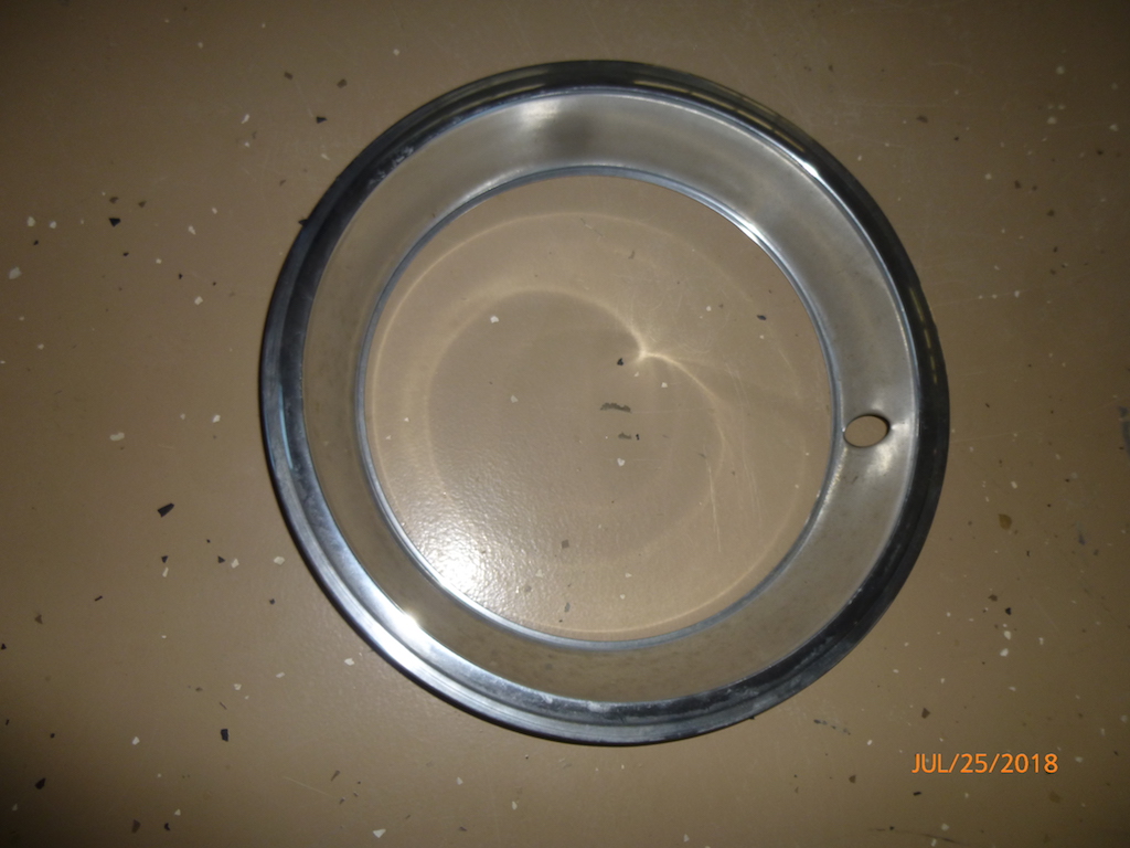

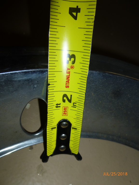

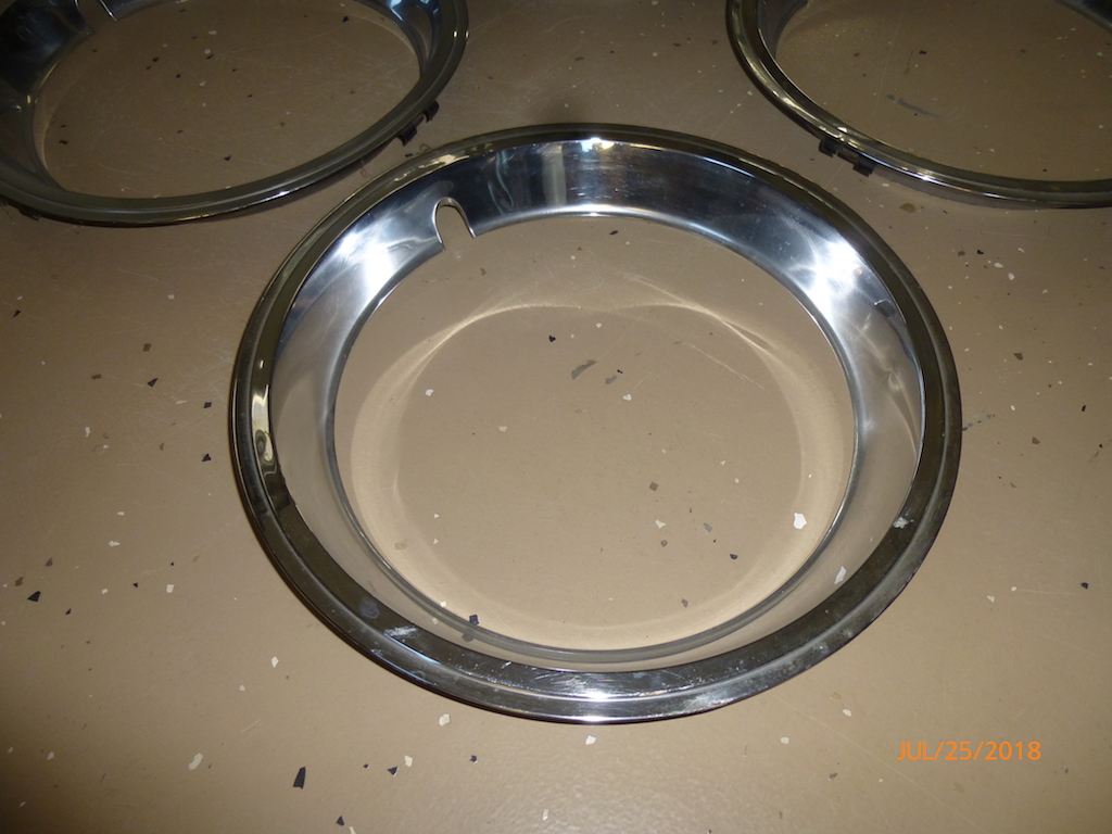

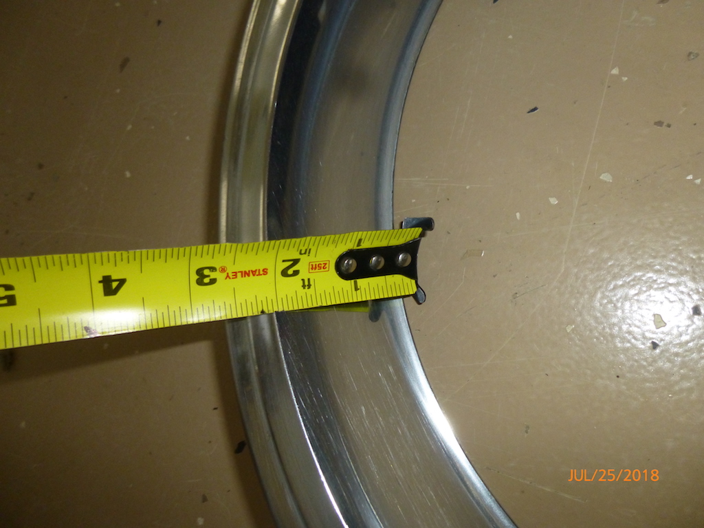

Both of these are 14". One is 2" deep and the other is 2 1/2". They are both original 4 clip rings.
I would guess one is 14X5 and the other is 14X6 but does anyone have more specifics on these?

The 2" is a 14X6 and the 2.5 is a 14X7
Or..open hole valve stem is the 6" and the closed hole is a 7"
