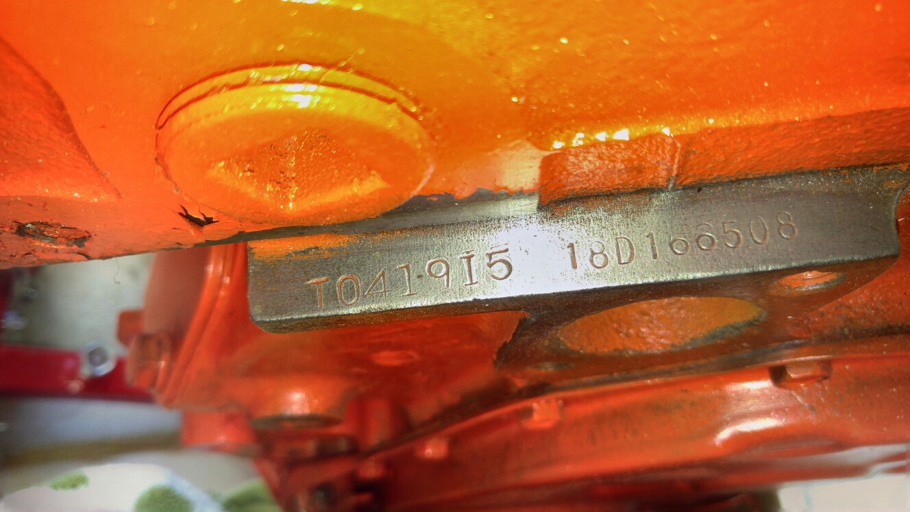

Hi,i posted on the Impala net forum that I found a weird 1968 396 with a I5 suffix
And they say I may have a real COPO motor
Here's a picture and what I found so far,
Any help much appreciated.
5th line down shows a I5 suffix
On a COPO 396
396ci/325HP L35 IG IV IA
396ci Police IN IF IK
396ci COPO 9565 (313HP) IY? IW --
396ci COPO 9559 (IZ, I2, I3, I4)
396ci COPO 9627 (I5, JB)
427ci/385HP L36 -- IJ IH
427ci L36 SS427? -- IS IE
427ci L36 COPO 9626 (I6, I8)
427ci/425HP L72 -- -- ID
* Engine code for L73 and L30 with TH350, used in
late-year 1968 TH350 test fleet
