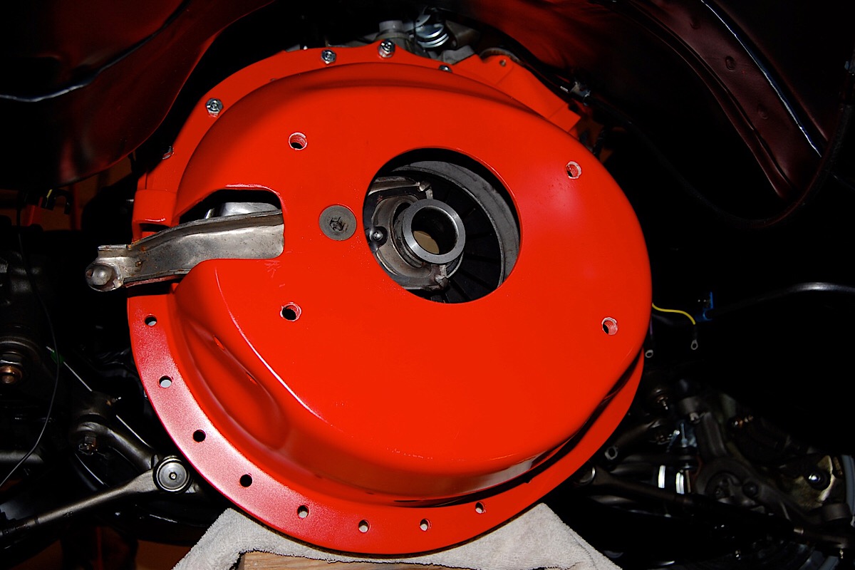

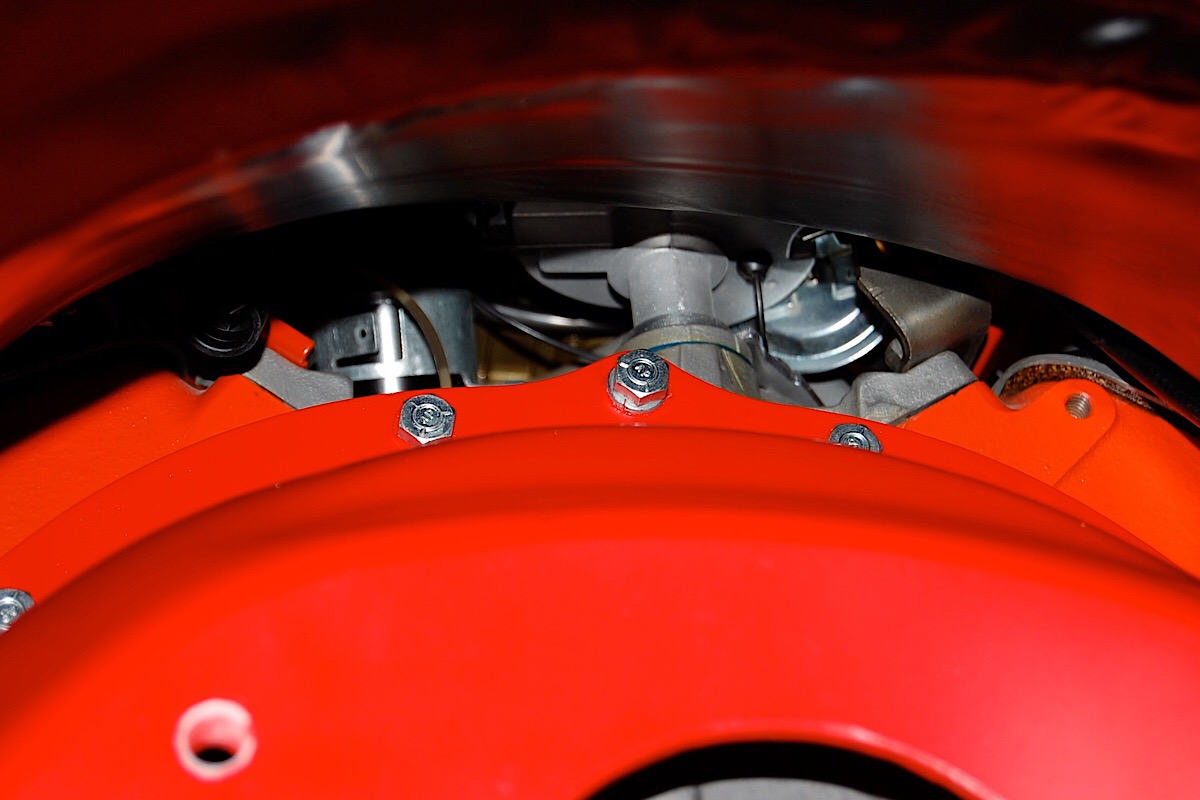

Some of the gurus may chime in, as I am not sure what Lakewood used. For example Ansen had their own cool in house "Ansen" bolts at least for their inspection fixture at the bottom of the scattershield. Here is what I have used and will use shortly for my next Lakewood scattershield. I go to AMK or Paragon Corvette site and purchase some, IIRC, 3/8-16 x 1" grade 5 bolts with vintage headmarks such as "AP", "M", or "TR". That way you are using a bolt available in that time period and not the H. Depot standard grade 5 bolts. I use a grade 5 nut and lock washer to keep things in place. I'll post a photo of the fasteners I used on my last scattershield project on my '70 Nova SB later on.

Lakewood fasteners....

The bolts look very good
Top shelf detail in your build very very nice!

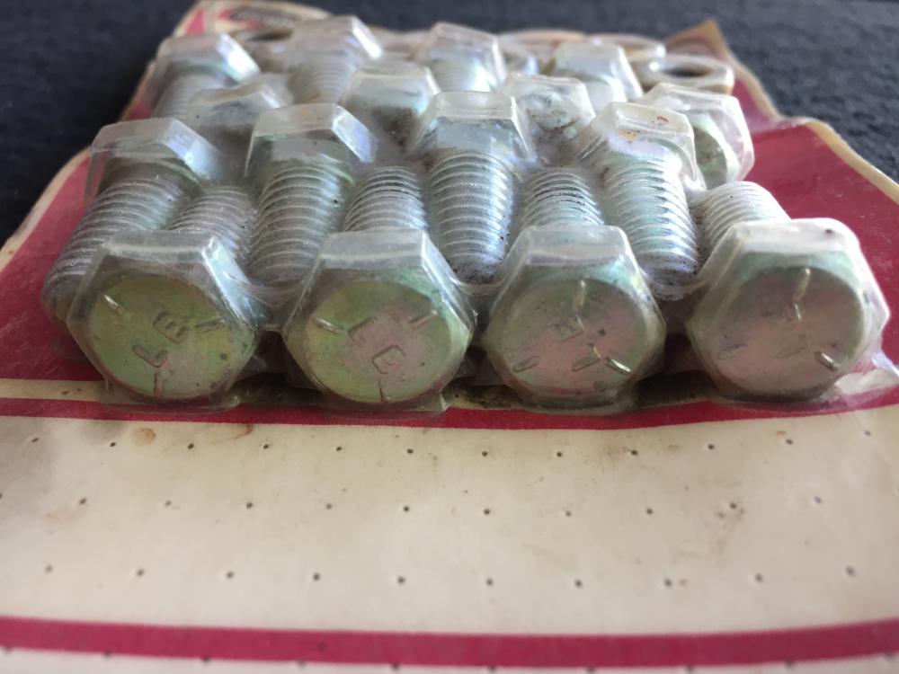

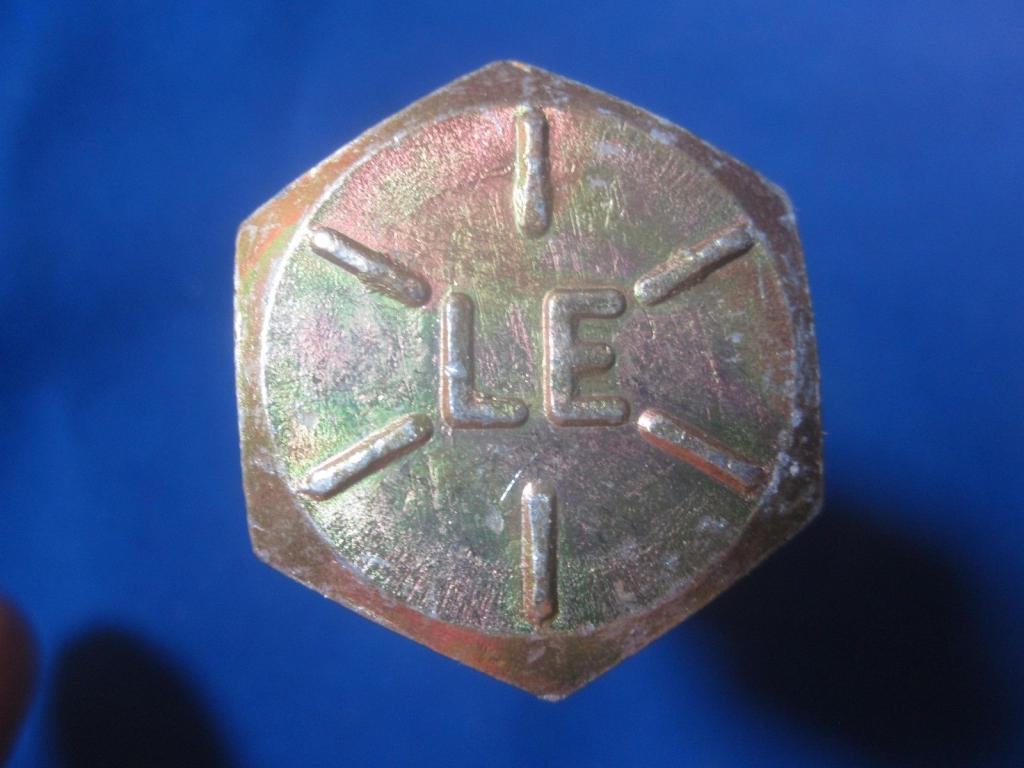

The hardware, bolts, used on the scattershield were manufactured by Lake Erie and were identified by the manufacturing marks "LE" embossed on the head of the bolts. I have attached the actual Lakewood Hardware package "1581" for reference.
I hope this helps.
Hardware:
Bolt grade - 5
Head style - Hex cap
Lock washers yes/no - no
Washers - yes
Bolt color - zinc dichromate
Bolt head markings - LE
Scattershield:
Part No: 1510
Block Plate No: 1573
Bolt Pkg. No: 1581

Dana - that is some good info and pix too! Thanks!
P.S. What is the application for the grade 8 "LE" bolt that you pictured?
