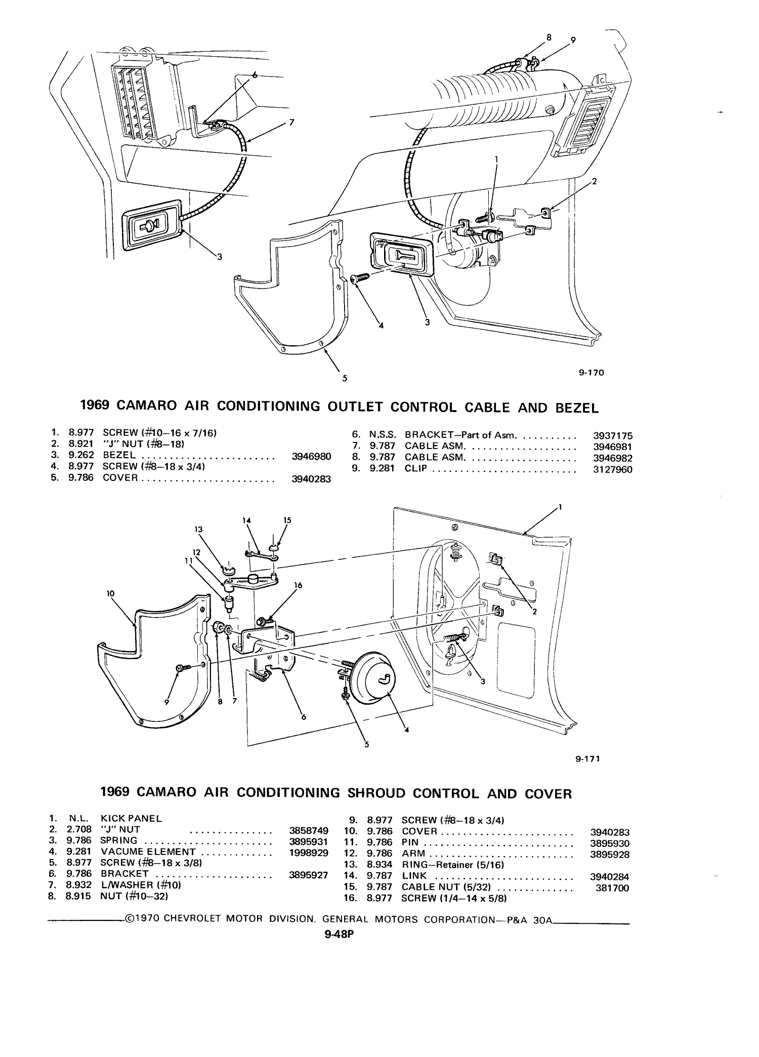

Hello fellow Camaro enthusiasts . I purchased my 69 Camaro AC car without kick panels. I purchased oer panels and the appropriate cables with lever. I know how the bezel screws to the kick panel but I have no idea how the cables are supposed to be routed. I'm almost certain that the passengers cable or duck behind the actuator cover but I'm not certain. I have absolutely no idea how they cable routes behind the kick panel for the driver side because there's no hole for the cable to dive behind. Does anyone have any pictures and or experience with the installation of these cables. Thanks

This might give you an idea on the kick panels.

That's what the vacuum and bracket i have is for
