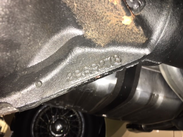

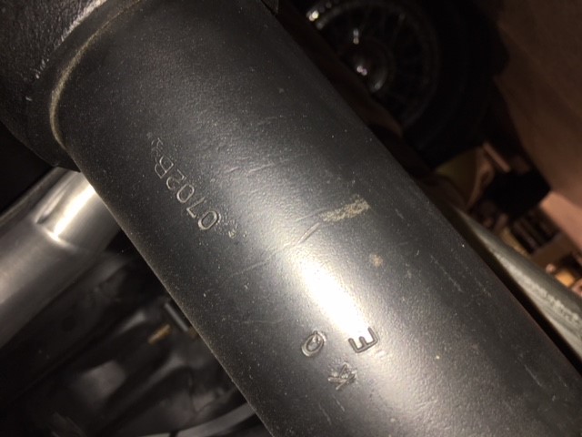

Hello all, Just joined. I am looking at a 69 COPO and checking the
numbers on the rear end. The car has a build date of 07 E in Balt.
The rear end is stamped KQ, with a date 07 2 B
The casting # is 3969278, which is according to my research a 70-72
casting #. There is no casting date on the web opposite the casting #.
Looks peculiar. Is it possible GM used a 1970 pumpkin w/o a casting
date for this 69 COPO? Thanks, Dave

Dave, I just posted on this on TC. I'd question everything about that rear until you find the center section date casting.

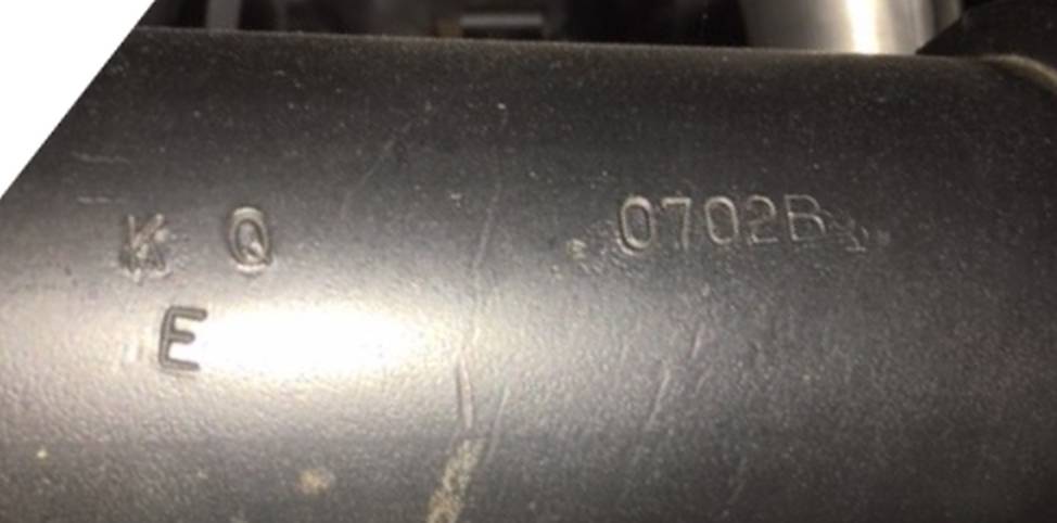

Is KQ a correct code for a COPO Chevelle? Were the BE rear ends just Camaros?

According to Chevelle stuff.com, KQ is a COPO Chevelle Code

I don't see many Chevelle axles, but that stamp font looks off.

427king, just wondering why that KQ doesn't have an E on it? Didn't the COPO get the special Eaton Posi and didn't rear ends with the Eaton get stamped with an E? I'm still learning a lot about stampings and codes.

----Chuck,,, where does the KQ appear on the axle. I know its on the left side, but is it on the front or back of the tube and could it have been in either place???........Bill S
