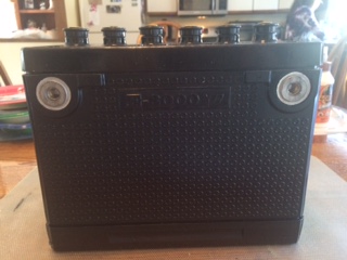

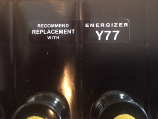

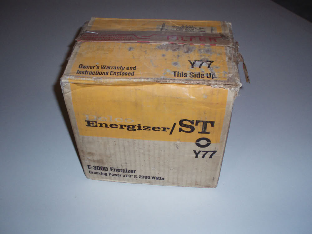

My plan for a 302 Car is to "WHY" Yellow it out, the Z28 using the Y55 & Y77 are the the "normal" Yellow E-3000 series ( Amp hour rating of : 45 Ahr)
So a compromise would be to Yellow out the restoration battery by using Yellow painted delco eye caps & The color was used on the caps and to highlight some of the text on the battery; to give it the appearance of the reverse post batteries which are currently not available.
I saw someone post a Y77 conversion of the current side post offering in a effort to look the part. Nothing you can do about the positioning of the posts in relation to the fenders etc.
Might be a good option.
