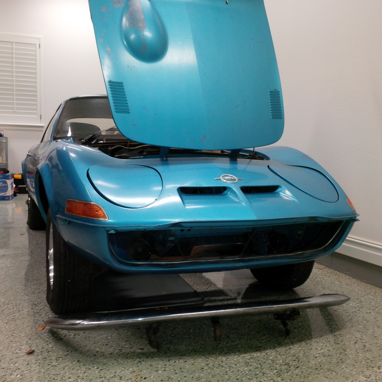

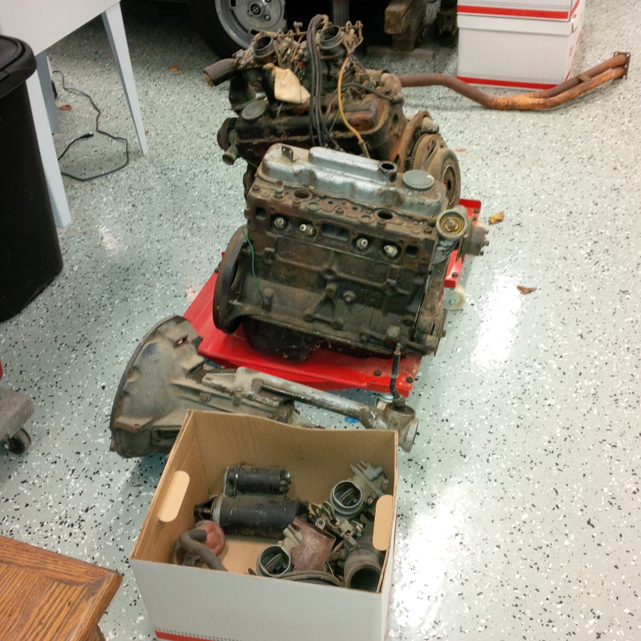

I bought an Opel GT 1.1 as a basket case. Car has been apart since 1974. Other than the battery tray and a small rust through under the battery tray (already repaired and painted), it is rust free, and definitely worth saving. I even made a new friend in Germany who works for Opel, and he sent me a copy of what we would refer to here as the "build sheet" confirming that I have the original engine for the car. Also got another spare engine with the car.

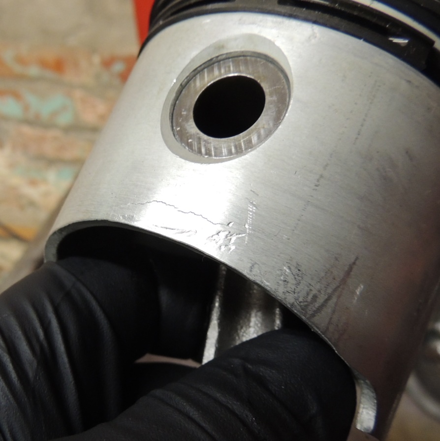

Picked them up and started to put it together last night. Noticed that all the pistons had some scratches. They had no scratches last week. Was able to clean them up with scotch pads for the most part. However, one of the skirts has a crack in it. It is on the side, so not in a stressed area. I also checked and it fits fine in the hole. Did not affect any clearance issue. I could probably put install this and it would run fine for 100k miles. But, if it were you, would you insist the machine shop spring for another set of pistons? They are not expensive ($200 a set with rings.... really good German quality).

Spend the 200 for new pistons. That car is cool.

FWIW, a reputable shop would take care of that issue. Maybe the owner / manager doesn’t know. Parts in that condition should never have left his shop and a seasoned engine builder should have noticed.
Reusing a cracked piston should not be a consideration. If and when the skirt lets go it can cause a bunch of expensive and/or catastrophic damage.
$200.00 is an easy problem to take of if you have to.
