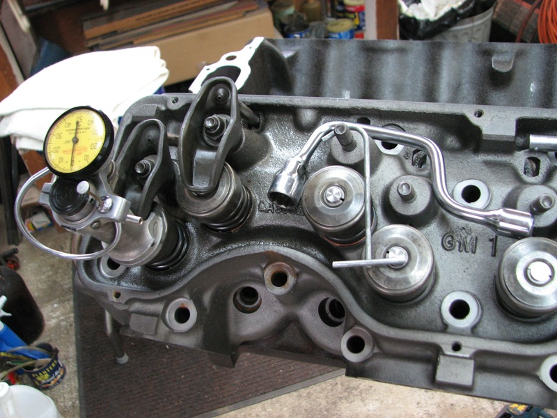

Then good rockers get transferred on and my trusty P&G took care of the valve adjustment. Yes, it's tedious to remove the handles and swap to other rockers, then back again to lift it off, but it saves my fingers and eliminates the prospect of accidents.
