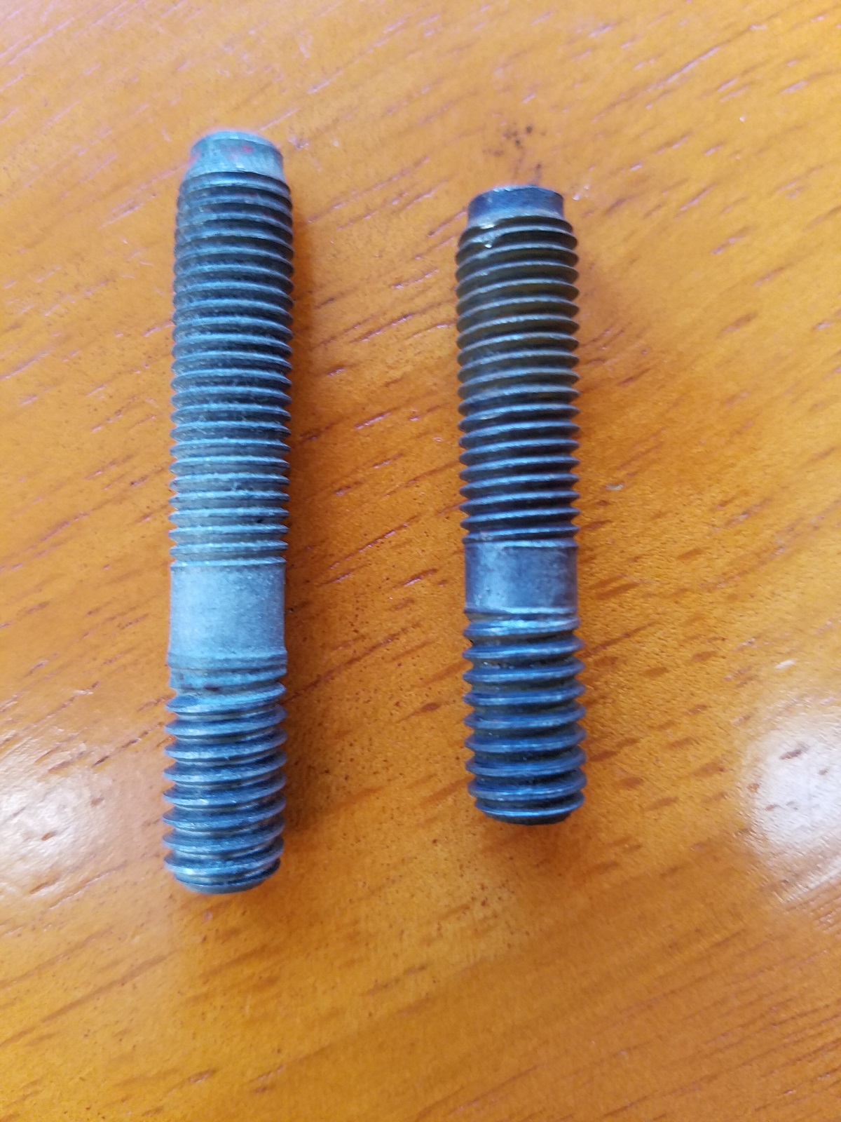

Originally Posted by ALLZS View Post
Is one of these correct for 69 camaro with holly carb the silver one is 1 1/2 long and the black one is 1 7/8 long
My untouched LS6 Big Block intake #3963569 that I have in the For Sale Section had the original studs that I removed and they measure 1 7/8 long.
I removed them thinking they were the same as the 67-69 302 Z28 studs, but they were not. The Z28 are shorter and measured at 1 1/2, however they are identical in appearance.
The stud on the left is off the LS6 intake and the one on the right is off my 67 Z28. Notice they they both have a dimple on the bottom side. Also the Z28 stud still has remanence of gold cadmium plating.

Great comparison pics here.
