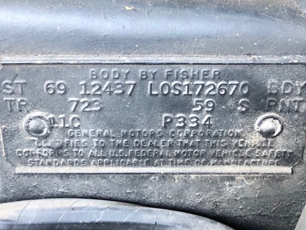

Default 1969 Trim Tag Question
What does the S mean next to the paint code?

Dark Green Vinyl Top..?

Default S on cowl tag
You are right
Midnight green vinyl top

59 would be Frost green body color

Decode here: http://www.camaros.org/numbers.shtml#ExteriorColors and scroll down to Vinyl Top Color chart.
