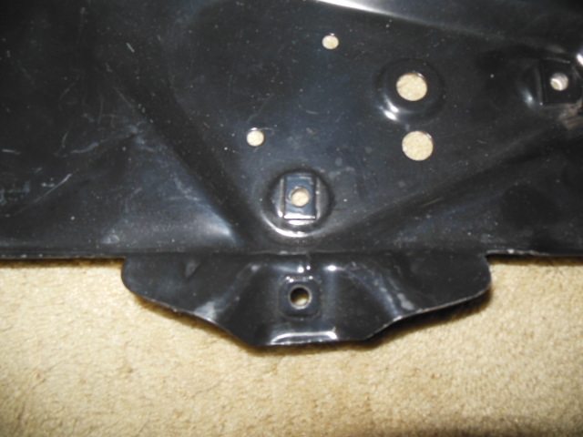

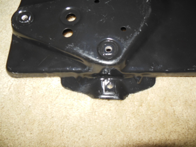

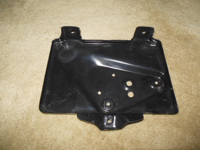

How do you know if a battery tray is assambly line correct or over the counter nos ? Here is the one i have

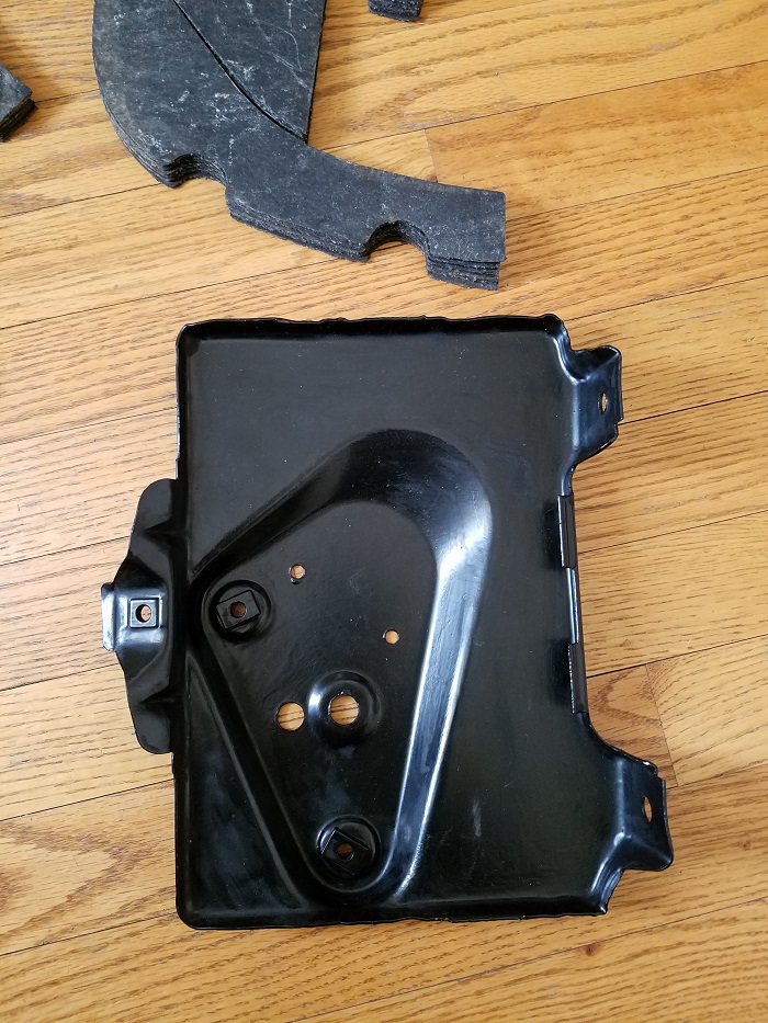

The angled nuts and the additional tang where the clamp bolts up. Here is a picture for comparison. Thanxs Dave

So is this one correct ?

the one you show looks like a NOS piece

The one you have pictured is a later NOS and technically not correct.
