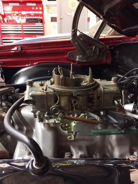

I think you'll find that there is only one place on the carb where the cable fit naturally. I'm not certain that the Q-jet cable above is correct (it may be, but it looks "off" to me). See how the cable end is tweaked "up" instead of aiming straight ahead?
It operates better when the cable ball stud is inline with the bracket, as shown on the Holley pic.

1969 L78 Chevelle. Does this help?
