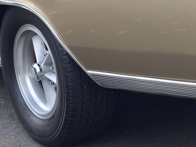

American Racing made the T70 wheel and T70R in a 8.5" width designed (I believe) specifically for a 68 up Corvette. Here's a picture of a T70 in a 7" width which is the only picture I have at the moment. AR also makes a new version of at least the T70R maybe both

better pic of t70........i have no idea who the seller is, just providing a pic
