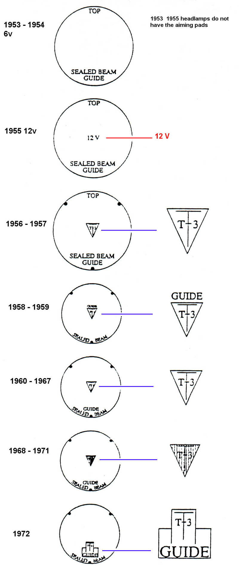

Does anyone know what the Original headlamps for a 1969 Nova are?

T-3

Ink stamps on the upper rear side of the bulbs can be washed off very easily, so be careful when cleaning.

T3s..

I thought only dual headlights on each side got T-3
My Nova has 1 on each side, Would they be T-3 as well?

Single headlights had T-3's also...
