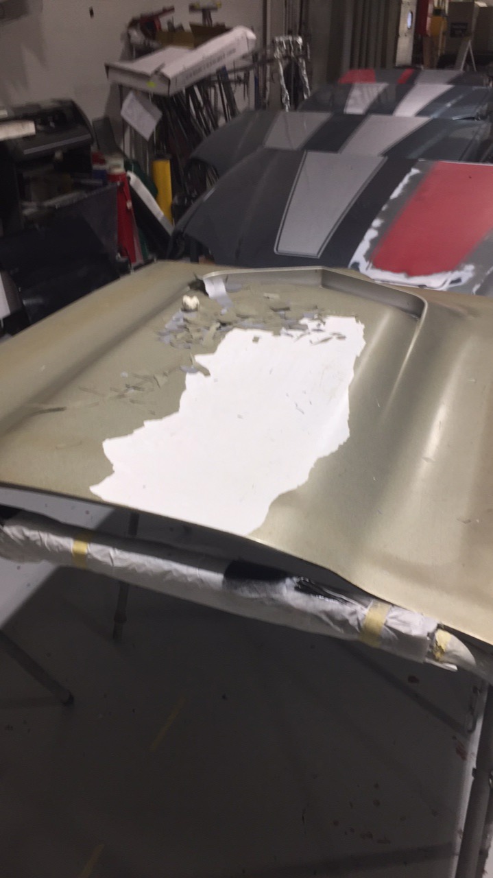

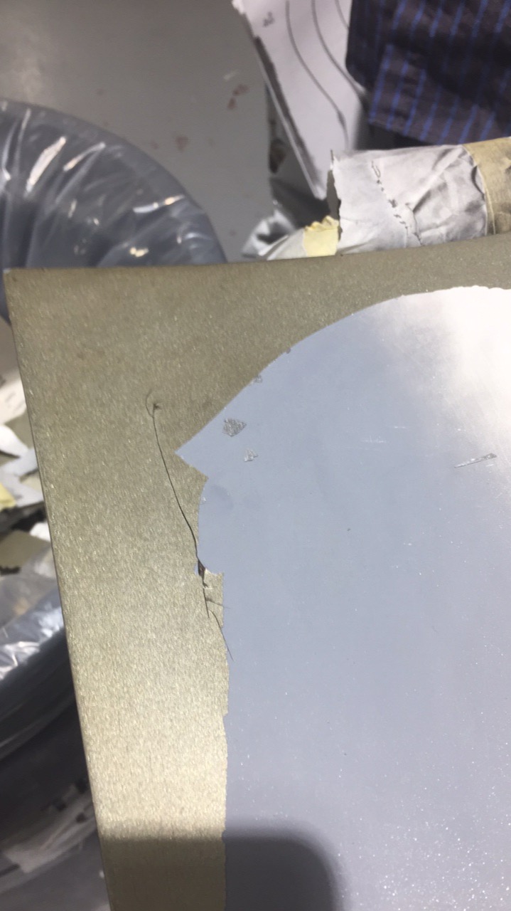

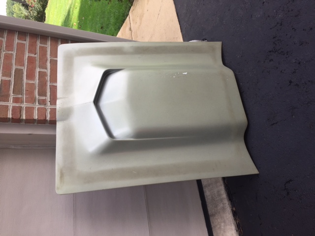

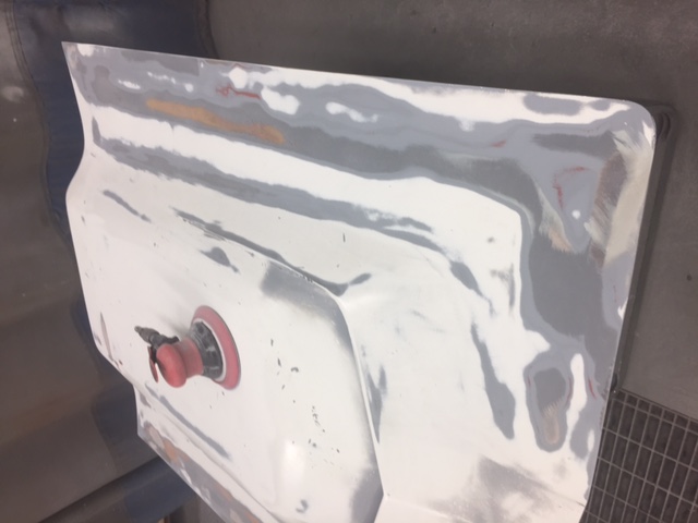

The cool thing about being in a restoration school is that I can bring in parts of the car to work on if they are applicable for what the class is on. I brought the car's L88 hood in to for some paint and body work. The hood is from the early to mid 70s and was in need of some attention. My plan for the hood was to strip the old paint off and repaint it the original GM Silver Blue that the rest of the car would be painted. The hood is made out of very cheap fiberglass and right where the scoop was mounted to the hood, there was a serious crack in the passenger side rear corner. This was going to require some fiberglass work, which I had never done before. Stripping the hood was an easy process. The old lacquer paint was so old that all it took was a pair of needle nose vice grips and a box of razors and quick work was made of the old paint. The paint coming off the hood was cool because under it you saw how the paint looked when it was fresh, and that gray had some serious metal flake in it, so it was very of the times and very "groovy". The only problem I had was sanding the gelcoat. That stuff is super thick. The hood has now been skim coated, sanded and will be ready for primer very soon. Problem is I only get one day a week with the hood since the class it's for is one day a week.
