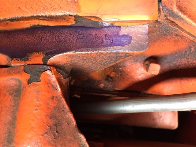

Can anyone decipher these numbers?
this is on a Small Block Chevy
VO528ONN

It may be VO5280CNN

V=Flint Assembly
05=May
28=Day
CNN=1970 2bbl. 250HP 350cid with Turbo Hydra 350 trans. in a Camaro-Nova-Chevelle.

X2 What he said ^^^
