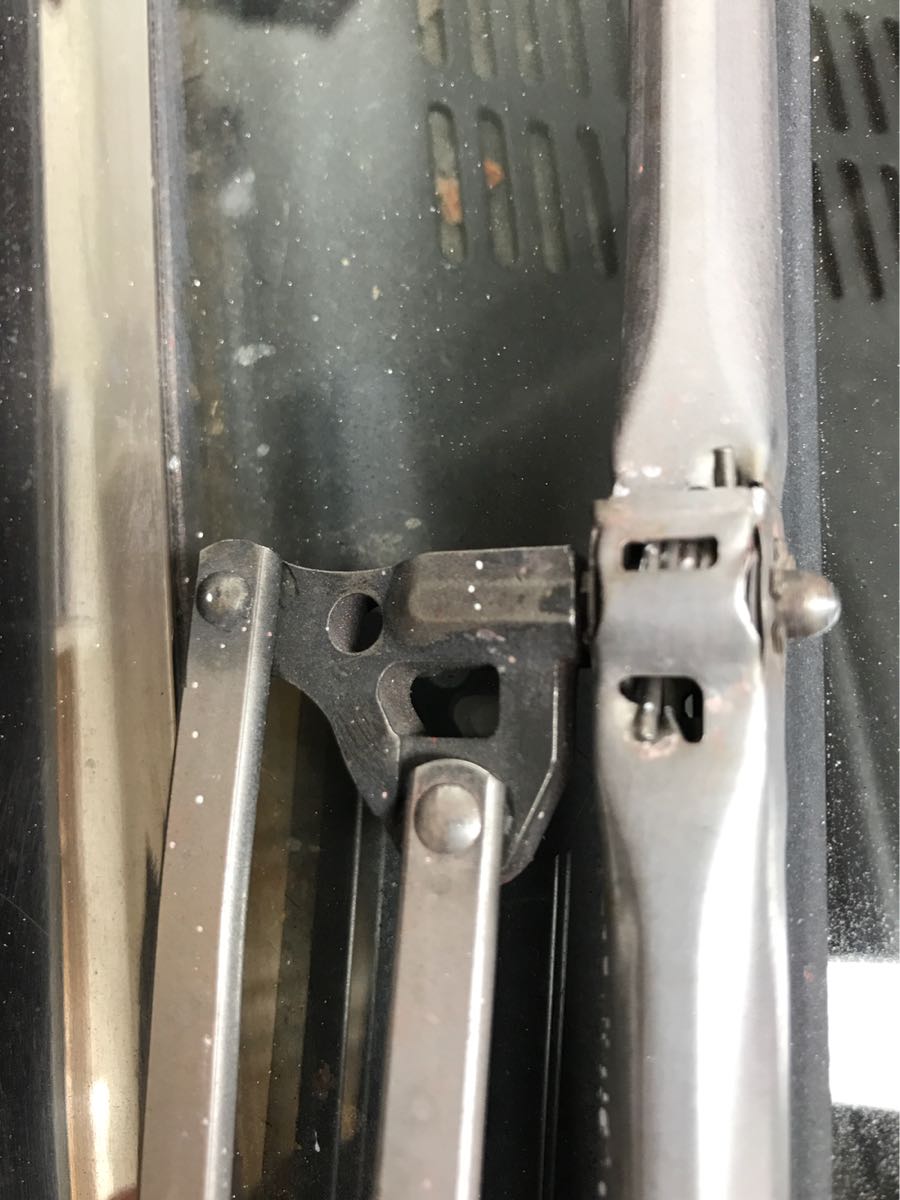

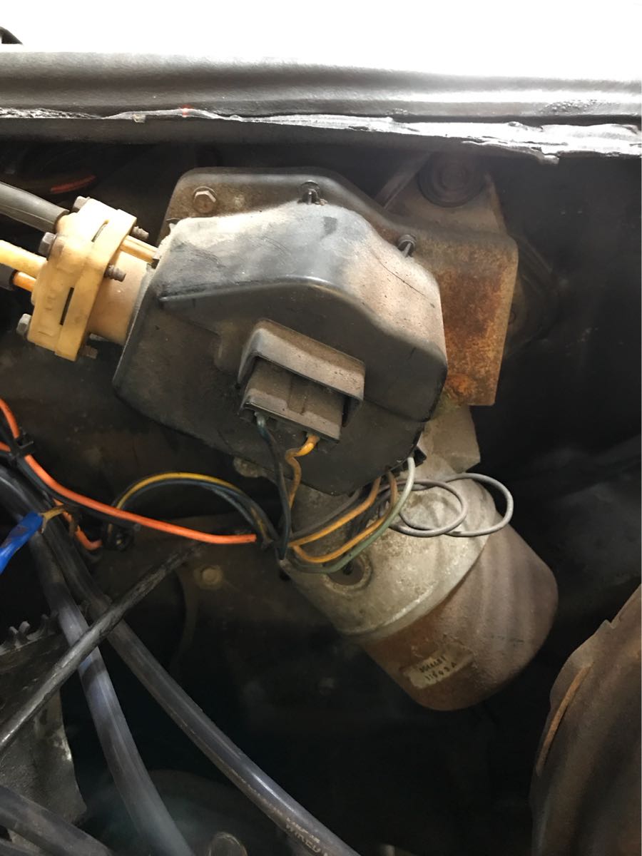

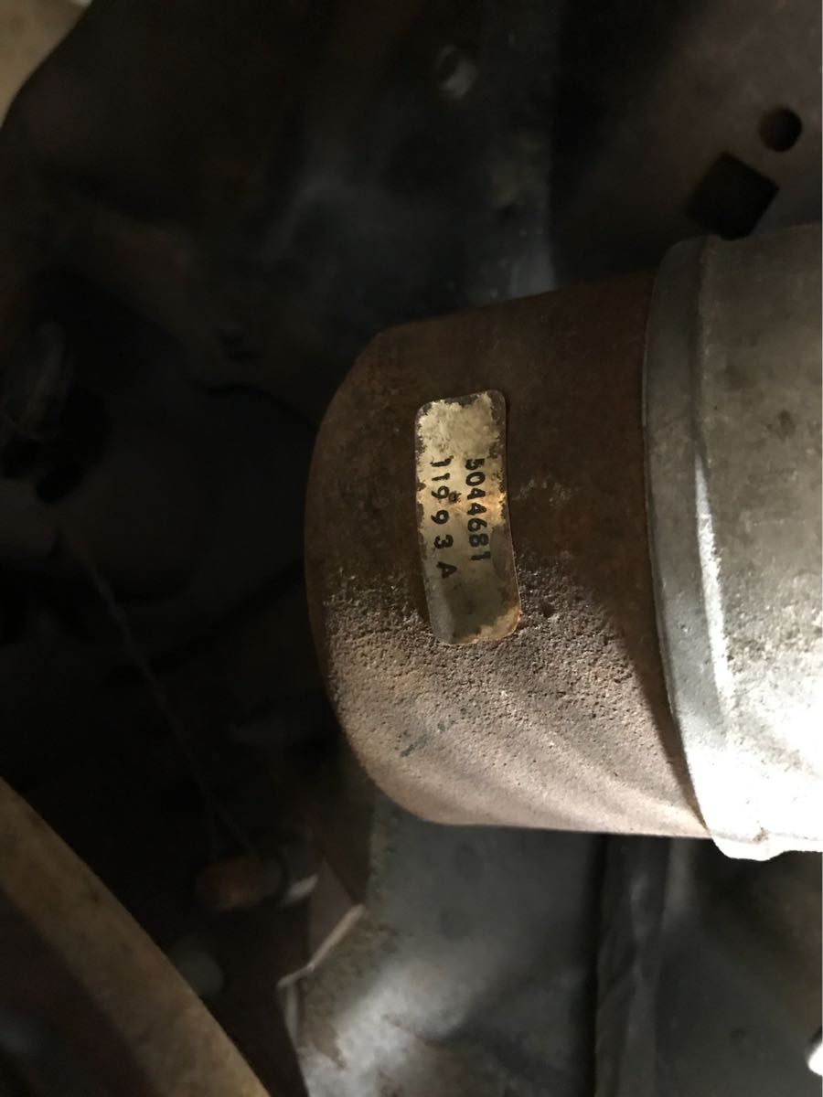

I thought I would post up my car’s wipers a may be easier
