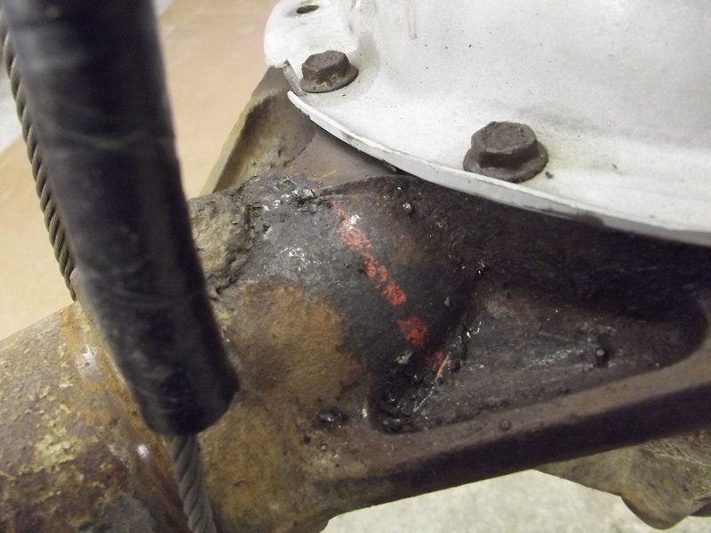

What is the correct" or is there " inspections paint marks that where original to 69 camaros ?
Attachments - The Supercar Registry DSCF2495 - Copy.JPG BE stripes1.jpeg BE stripe org.jpeg 100_1569 w.jpg

Found this photo

There are no consistent marks that I know of. I'd restore it w/o.

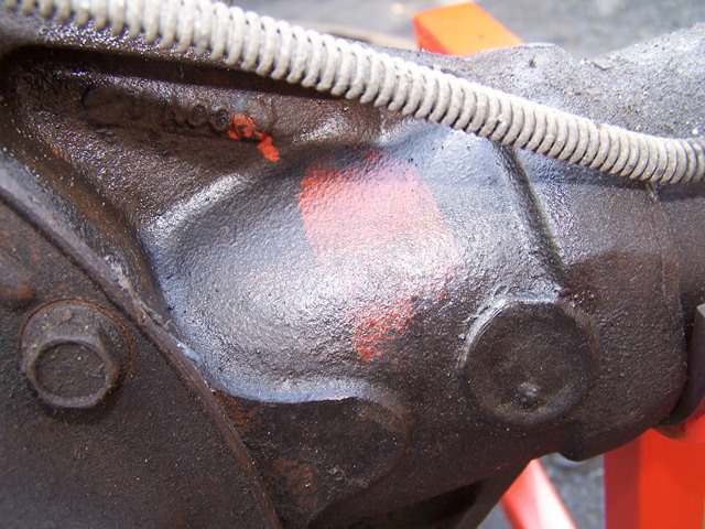

At least 3 12 bolts out of 69 Camaros that I have, have a splash of orange paint visible on the pinion nut and yoke.

June BE axle, only paint mark I have found to date.

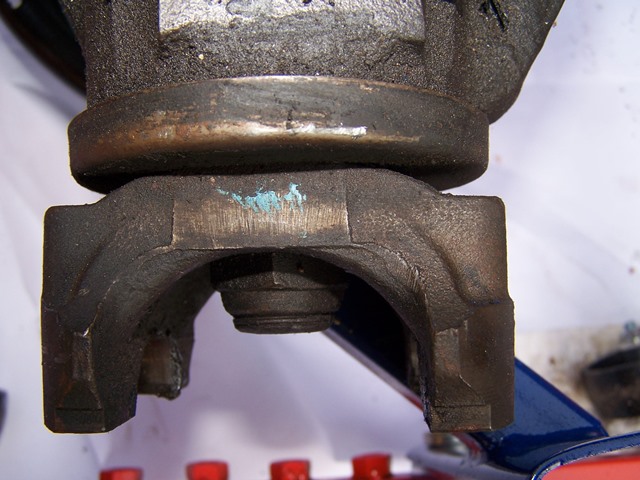

Sample 1969 "BL" 12 bolt as found
Jim
69 Los Z11
68 SS/RS 396/325
68 Los Z28

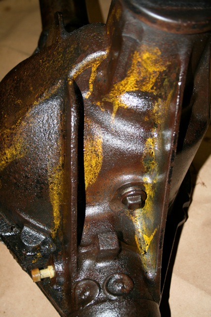

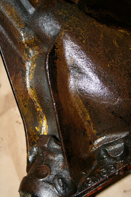

Lots of yellow paint on this 4 29 BE
