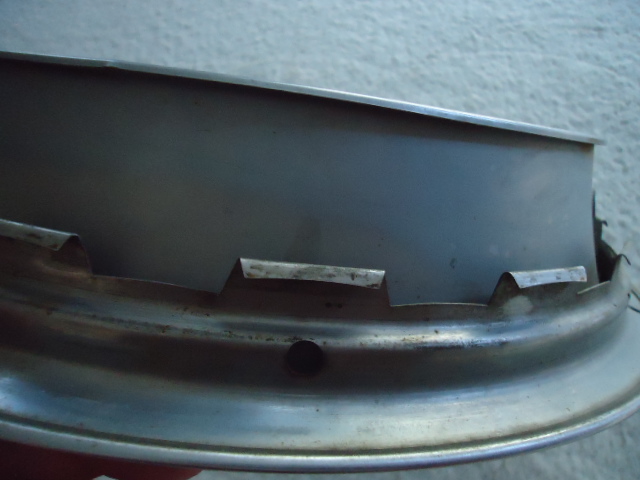

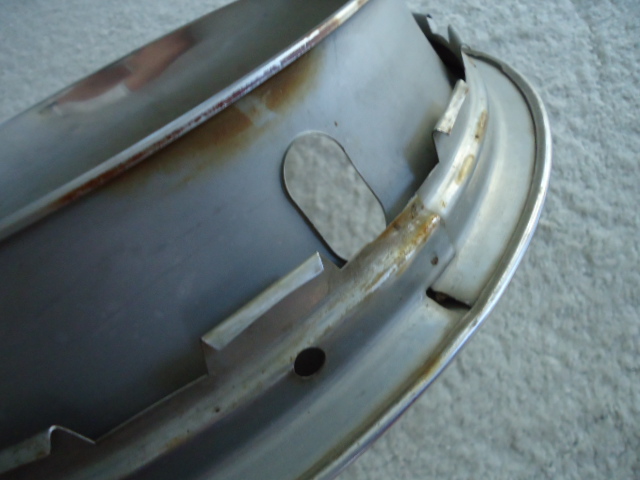

A June car to my knowledge took the 4 clip rings with the narrow oval stem hole. Here are a couple reference pics of the factory issued (early) trim tings with the narrow stem hole and the 4 clips that are just a pleasure to get on and off.

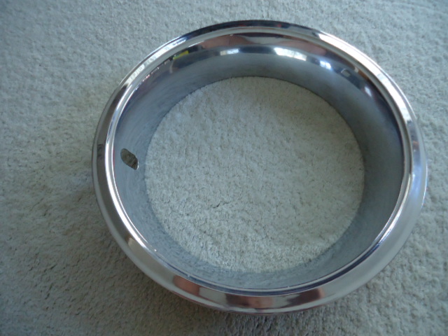

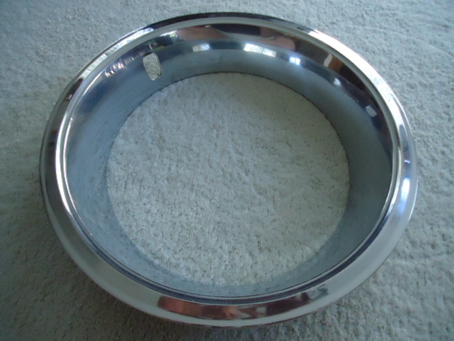

In addition to the late model year trim rings that have the larger oval stem holes and the serrated retainer rings, there are these ones which have the stem holes notched from the inside of the rings. I believe these are the ones that were available over the counter for many years. You still see a lot of these on eBay but they are not assembly line correct and are easily spotted due to the notch.
