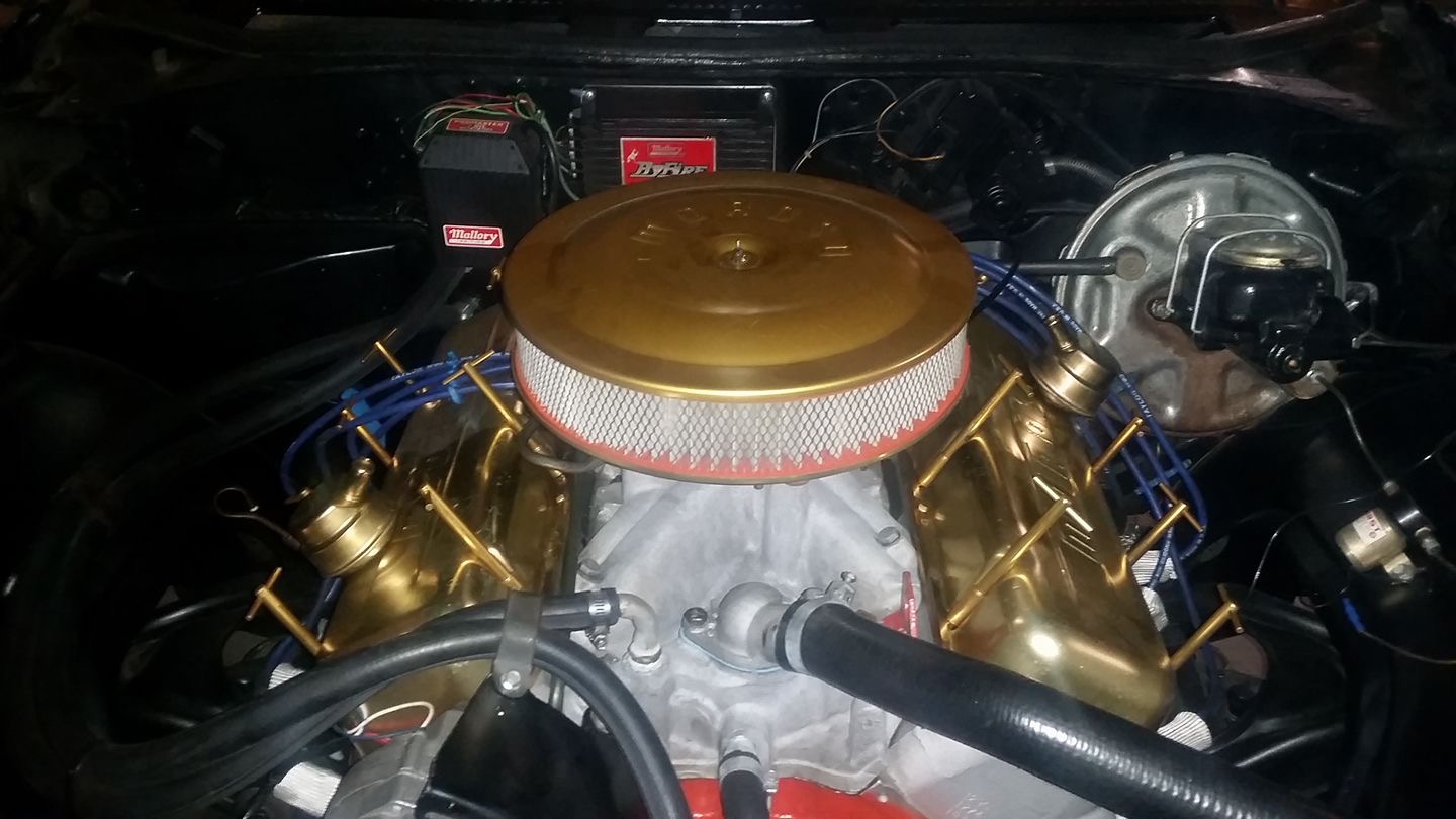

I'm considering running hoses from my Moroso Chrysler style valve cover breathers to the tubes that already exist in my headers, with a check valve. A friend told me to be careful as he knew someone who did this and literally sucked all the oil out of his motor.
Any thoughts would be greatly appreciated, Kurt

Do your valve covers have baffles in them under the breathers?
Dave
67 Nova Boy
A pan-vac gone crazy ...
Dave
67 Nova Boy
No.....

Which issue are you having that you want to run the hoses?

I have a friend who runs a dyno and that setup creates horsepower.......and I figured it wasn't hard for me to do it since the pipe is already installed in my headers.

Gotcha. I have thought about doing a evac pump system if I were gonna build a high horse motor. But Im poor so I dont have to worry much about that..
