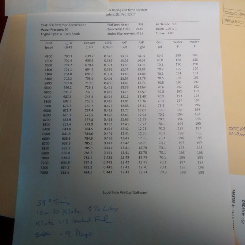

So HOPING to make it to the dyno tomorrow with the 1969 "052" ZL-1, here are some specs:
- 1969 052 block, 100 over
- Eagle 4.00 stroke so 475 inches
- Eagle +.250 rods
- Je pistons
- .904 Comp roller lifters
- .715 .258 on .114 Comp cam
- trends pushrods
- 1969 074 heads ported with 2.25/1.94 valves
- Comp 1.7 roller rockers
- 1969 198 dual plane intake ported
- reworked Holley 830
So what's your guesses?????
