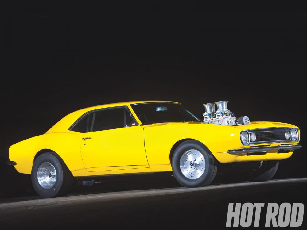

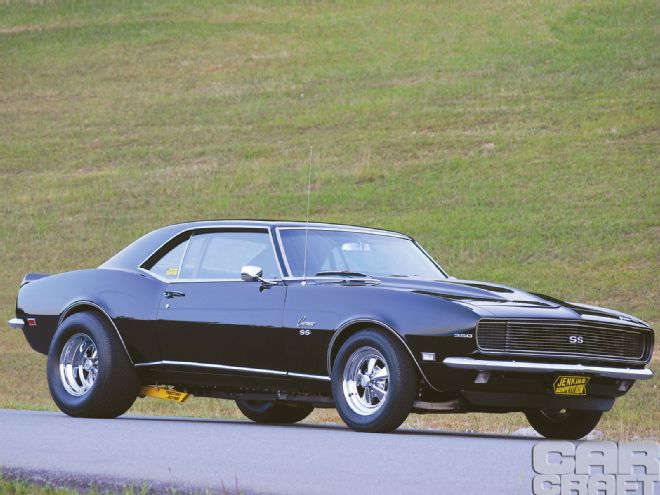

Looking for some advice on fitting L60-15 or possible N50-15's on my 68 with Centerline Auto Drags. I'd love to stuff some fatties on the back with skinnies up front for street cruising but really need to figure out what the maximum backspacing is running an 8.5" rear wheel or possibly a 10" w/o them sticking out too far? Will the 8" or 10" work with 4.875" backspace or will they hit the springs?
Anyone run 15x10 rears with N50's?

Here's one of the greatest Day Two '68 Camaro's ever with N50's
http://image.hotrod.com/f/33327922+w...evy-camaro.jpg

NorCam, here are the specs from the article, and a link to the original article about that Camaro:
Wheels/Tires: This is where some folks just don’t get it. Cragar S/S wheels that protrude past the quarters are out of style, but they are absolutely perfect for this car. The fronts are 15×4.5, while the rears come in at 15×10 inches with 4.5 inches of backspacing. When you consider the 26×7.5- and 28×12.50-inch Mickey Thompson rubber, this combination would’ve been a car guy’s dream in the early ’70s.

Mark the rear Cragars in the photo are 3.75 BS not 4.50. Ratpack, Troy C built the car. Never take what Hot Rod says as accurate. They just wrote an article saying the first CC Street machine Nat's was 1977 when in fact it was 1972.
You cannot run 4.50 BS 10" Cragars with N-50 size tires on a Camaro as it will rub the springs-you can 10" with 4.50 BS with L60's though (P275-60-15). You can also run N50's on a Camaro with 8" wheel deep dish 2.50BS
