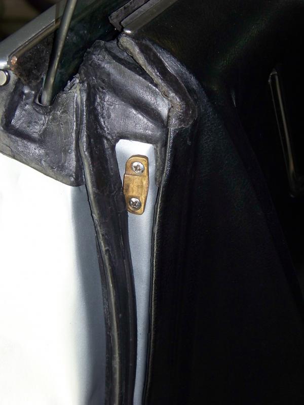

For original cars I have repaired splits and ends which are roughed up from abrasion. The ends of this one were re-dipped in black latex and then cured.
