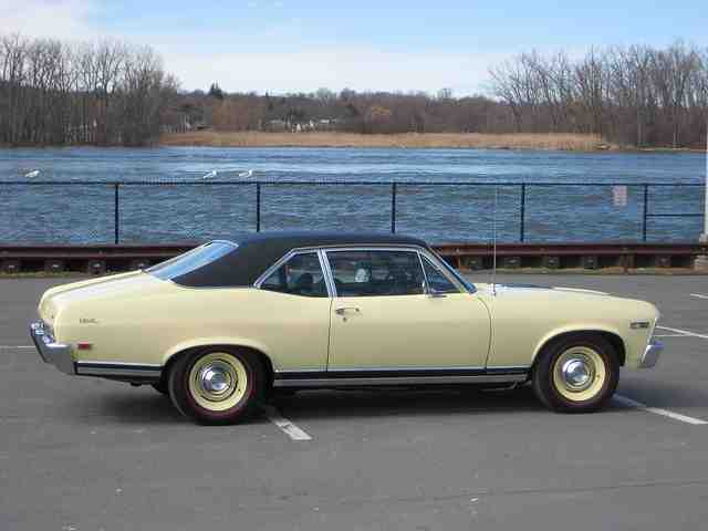

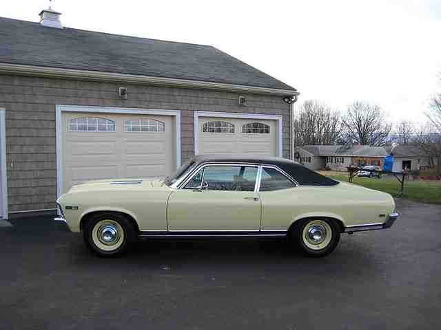

Jed, there was a great article in Nova Times a few years back showing the install and paint application for the lower rocker moldings and trim. I'll try to post some pics of a couple of our cars that have it....may be easier to email them to you, since the files are probably too big. As for the interior stuff...the 737(n/a in 1970) was a deluxe blue bucket seat and the 735 a std. blue cloth. Are you working on 2 different cars or just looking at options...the std. interior would have different door panels and a rubber floor mat.

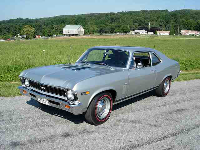

Here ia a 1969 photo...

Here is a 1968...

Another of the 1968..
