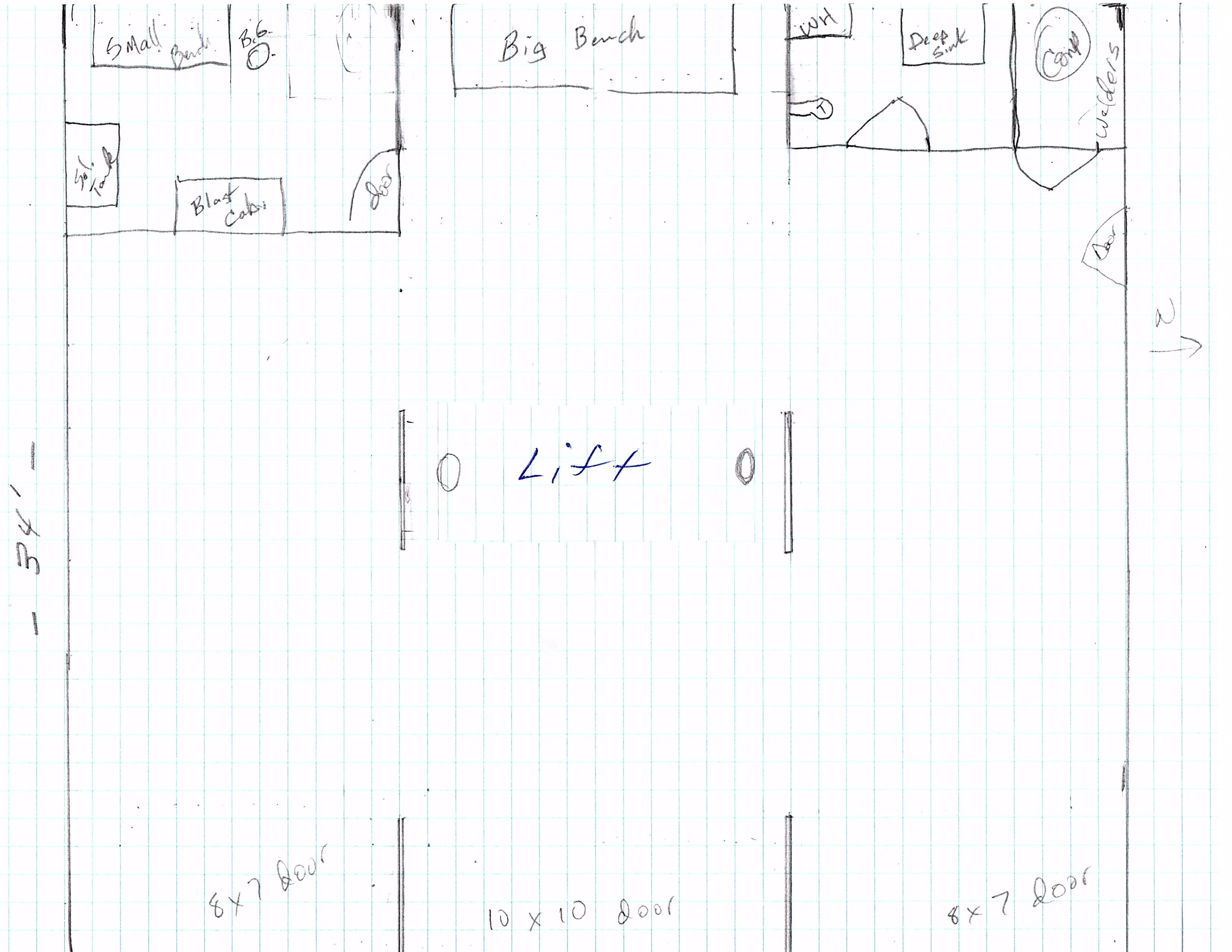

1. It is for working on cars. I don’t plan to do woodworking, or other projects
I need enough room to accommodate two small rooms about 10 x 10. One will be a bathroom (no shower, just a toilet and a deep sink) and will double as the compressor room (walled off) and storage for welders and welding rigs. The other room is what I call the dirty room, which will have a small work bench, a bench grinder that will double as a polisher, my solvent tank, and a sand blast cabinet. Don’t want it too big, as I don’t want to end up storing crap in there. Just do the dirty work without getting a ton of dust and dirt on the projects.
2. Must have room for a two post lift. I already have the lift, a used Ammco ; 137 inches from outside of posts. Has to have room for another vehicle to sit on a flat, for those projects that will take two cars to make one.

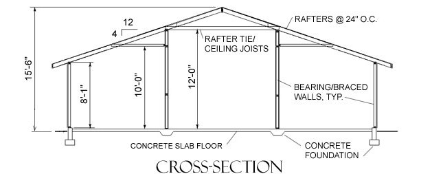

6. I prefer not to have engineered trusse. I realize that means no clear span of the entire garage. However, because the lift is already something I have to walk around, maybe it wouldn’t be a problem if the inner supports were close to the lift.
So, looks to me like an oversize 3 car garage will work fine for what I need. Has to have 12 foot ceiling in at least one bay to accommodate the Ammco lift.

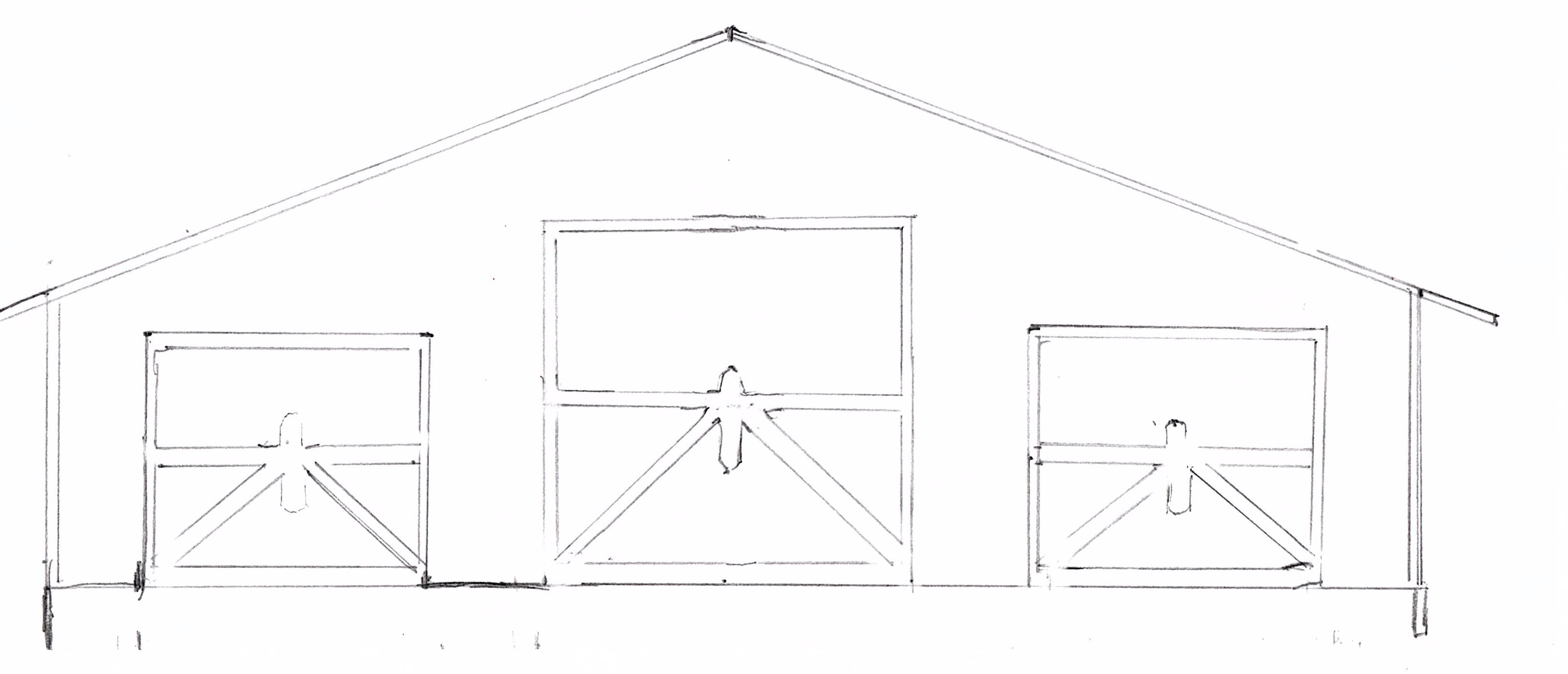

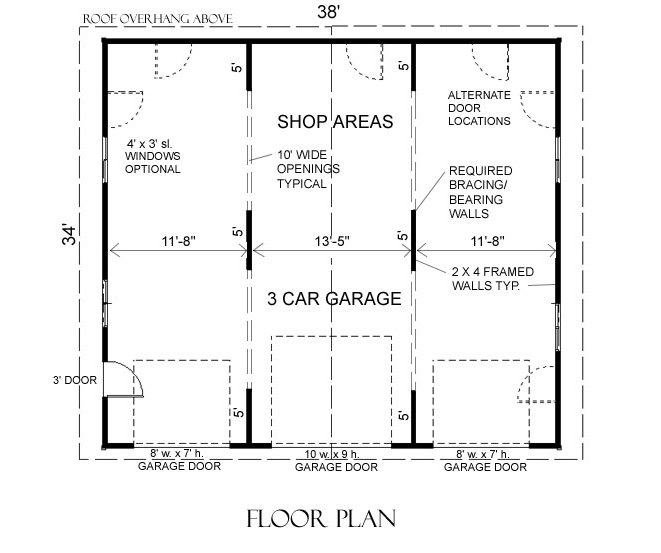

I found some on line plans that look very close to my specs. 34 wide, 38 deep. Pics attached. First pic is the front of our home when it was in the historic homes tour. Rest of the pics are of the proposed shop. You can see on the last one, that I am considering building doors to match our home’s faux door, even though there are two buildings between the home and the shop. We own those buildings as well.
Where the “lift” sits can be moved a bit forward or back.
Obviously, I don’t want to be cussing those two 5 foot long walls on either side of the lift. Trying to figure out how big a PITA they are going to be. The ones up front and at the doors really don’t bother me at all. In fact the front ones are necessary for me to add the two rooms anyway.

If you are not using the attic space for storage I'd go with the engineered trusses - they can make pretty much anything you want in terms of span, pitch and ceiling clearance. I'd also think twice about having those walls in between the bays as I think open space seems to work better over time. As your use/needs change you are not encumbered by bearing walls that get in the way.
