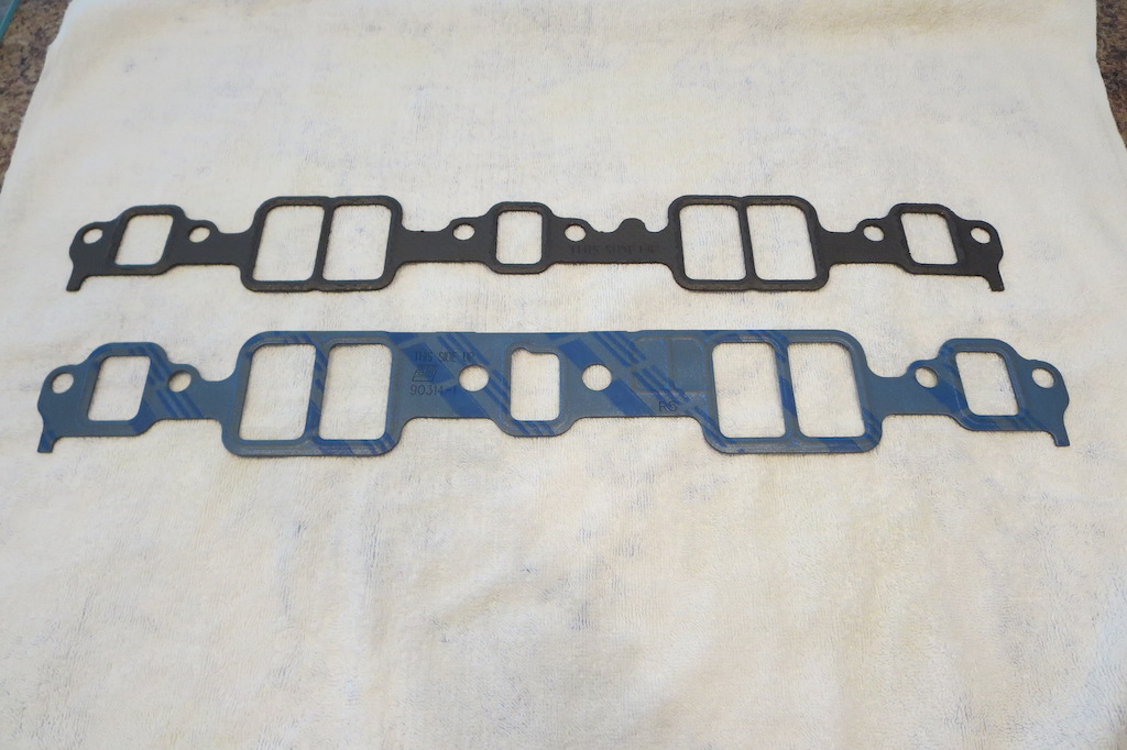

I'm looking for a set of early pre EGR intake manifold gaskets for a small block Chev. Specifically for the 327 in my 1967 Camaro. Attached is a a picture showing the currently available Felpro gasket with an early Victor at the top. Since the intake manifold for the 327 has no EGR provision the Felpro gasket sticks out above the manifold and does not look stock. Anybody have any ideas where I might find a pre EGR gasket? The Victor is really old and starting to flake so I really don't want to use it. It is from my inventory and probably about 40 years old. I could cut the Felpro but the steel core make the job difficult, especially for rounded corners.

Don't know if you are aware of this, but those blue fel-pro gaskets sometimes don't seal very well with aluminum intakes. I would use a Fel-pro 1256. I don't think these have a steel core so they should be easy to trim.
http://www.jegs.com/i/Fel-Pro/375/1256/10002/-1
Here is a link with a scan that shows where Edelbrock says DO NOT use the blue permatorque gaskets.
http://67-72chevytrucks.com/vboard/s...d.php?t=528147

X2 -- works better with the silicon bead around the port ... pay attention to torque also ... TAZ [img]<<GRAEMLIN_URL>>/smile.gif[/img]

Thanks for the comments and links on the various types of gaskets. I'm not using an aluminum intake so that is not a problem. I'm using the stock cast iron QJet intake. I'm aware of the issues with the types of gaskets for aluminum intakes as I'm a drag racer with various engines from bracket race to Competition Eliminator. I used to buy GM intake gaskets for my stock engines but now those are almost nonexistent as with other GM gaskets for older Chevys. Try buying a GM rear main seal these days. When I bought one at my local GM dealer there were only four in all of the USA and it had to come from a regional warehouse centre. Same with a timing cover gasket. Felpro has so dominated the gasket market that it is hard to buy anything else and some of their products are very poor and their tech centre help can be hit and miss. Really depends on who you get. Certainly stay away from their rear main seals. They are really bad. Not surprised that Edelbrock is making their own gaskets these days.
My concern here is the shape of the gasket. I want something that does not have the EGR provision that is like the Victor MS15114 on the top that follows the profile of the intake. The bottom gasket is Felpro 90314-1. Is this Felpro Permatorque? Doesn't say that anywhere. The head gaskets always say PT on them.

Now I am digging back to my Corvette days -- check these gaskets out. TAZ
http://www.zip-corvette.com/57-68-28...s-correct.html

Thanks earntaz: Just what I was looking for. I was told that it was possible that the restoration suppliers might have something. The gasket at ZIP you linked to looks exactly like the old Victor MS15114 I have. I'll see what I can find locally and if not I'll give ZIP a call.
