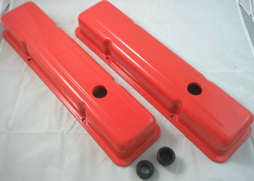

My 67 SS 327/275 used these covers with the 327 decal on the air cleaner and am pretty sure that was standard in 67. I believe the earlier years used the raised rectangle in the middle with the black decal. Real early ones used the Chevrolet script. Perhaps others can supply actual years for the change.

Going on the net I am seeing 1967 Impala 327's with the type I show above as well as the Chevrolet script style. Odd as I do not remember ever seeing the Chevrolet script on anything after late 66.

Regarding the pictures I posted of the covers, you are correct, they should have been closed covers with no vent holes. I was more referencing the top design. Sorry for the confusion. My 67 had the same ones I pictured though without the hole. Unfortunately I do not have an assembly date.
