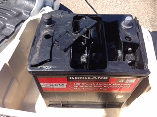

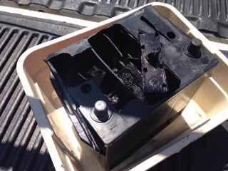

Anyone ever have a battery explode when turning the key to crank the motor. Went to start my 55 Chevy (L88,M22,411 12 bolt)as soon as power to the switch a tremendous explosion under the hood. It dented the hood with impression of the battery caps in the hood of the 55 above the battery compartment and that's not thin metal. Cleaned up the mess, put in new battery, fired right up, started to drive and like someone turned the switch off it quit. Cranks, fuel, but no spark. Is it possible the boom or the wash down took out the MSD 6AL box there's no power to the coil. Had a battery tender on it could that have caused it. Thanks, Larry

Usually an arc from a cell that was low on fluid sparks some of the gasses in or around the battery. It sucks to clean up but sucks even more to hear about the body damage.

I did, it was in a 84 Pontiac Bonneville. I had no clue there was a potential problem. Stopped at a Drug store and was there 10 minutes. When I hit the key explosion city, not allot of the case left, lots of it on the ground, and it was very dry too. Did not damage anything.
That could be ugly if your were there and the hood was up.

Back in 82 or 83 the Sears Diehard battery in my 1973 Ventura exploded as soon as I hit the crank position on my ignition switch. There was a loud bang followed by a puff of smoke coming from the hood seams. I carefully opened the hood and the top of the battery was blown off. Acid was everywhere. I rinsed it down for about 15 minutes. Sears replaced the battery for free.
Since then I have never stood near a battery when someone else was cranking the engine. Still a little gun shy 30 + years later.

Hello yea it was quite the mess. Hosed it off twice. So much I think it took the MSD box out not getting any voltage to the coil now. Always had heard of batteries exploding when being charged but never realized the energy that's stored in one.

That episode sounds very strange. It should take a spark to ignite the gases, I'd think. I think sparks mostly come from corroded terminal connections and the spark usually comes between the cable end and the post.
When I use a charger, I always unplug the charger before disconnecting the leads, then wave my hand over the top of the battery to defuse the fumes before hitting the key.
