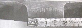

Hi, help is needed.
I have two engines that are hard to decode, at least for me. The first one is a V0215CHZ that decodes as a 1975 165 hp 350 engine , but the 010 block has the small pad and was cast in 1997. So it doesn´t make sense.
The second one is a 10054727-block from CANADA that is stamped K0220TPM. I believe it is a 350 out of a van but I´m not sure. can´t find the TPM-code anywhere.
Both have original stampings.
Anders Stålklint.

The CHZ decodes as 1977 350 170 HP 4BBL out of a Camaro.

TPM = 8-350 E.F.I. L05 Chev or GMC... Van application 1989

I think you have a short Pad 1977 350 Block there.
Mid '70s-up blocks use the short, fat style pad..Is this what you have?

This is what it looks like Phil. I read it A-2-97, but I guess it should be read A-29-7.
By the way,I can´t find the partial VIN down by the oilfilter. Where should I look ?
Thanks ! [img]<<GRAEMLIN_URL>>/biggthumpup.gif[/img]

I suspect a missed VIN stamp at the factory on this one.
