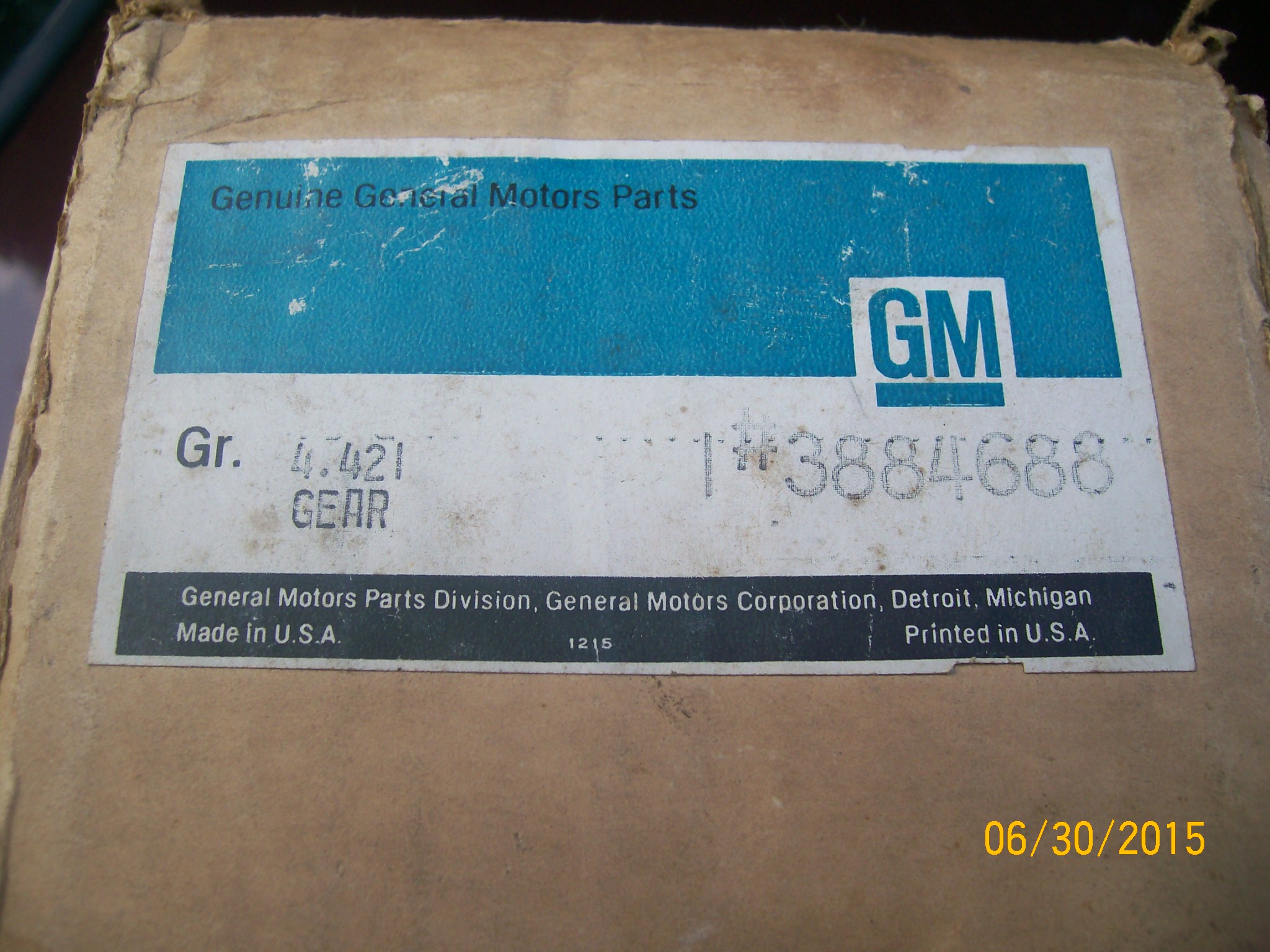

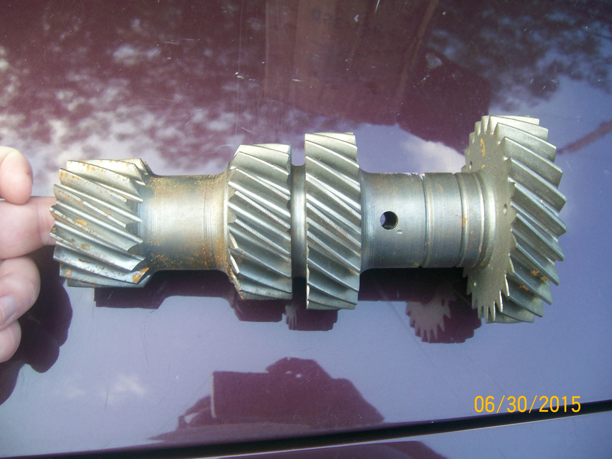

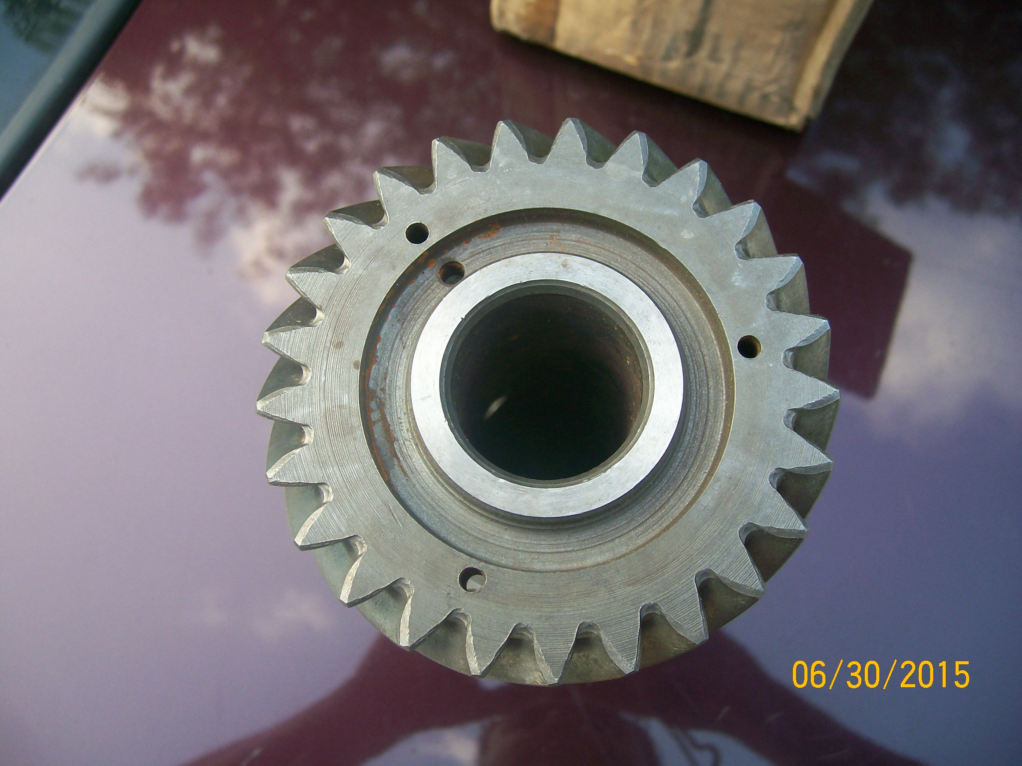

I have this NOS cluster gear that I am having a hard time identifying. The part number is 3884688 and the group is 4.421. It has 25-22-19-17 tooth count which comes back to a 66-70 M20 Muncie. I have checked Chevrolet parts history catalogs back past 1963 and nothing comes up. It is wrapped in a 10/12/65 Muncie newspaper. Thanks in advance for any and all help.

Number is not in my 1972 Oldsmobile parts book either.

1966-74 Muncie wide ratio cluster gear for a 1" cluster pin case(missing the anti-chatter plate on the front)
