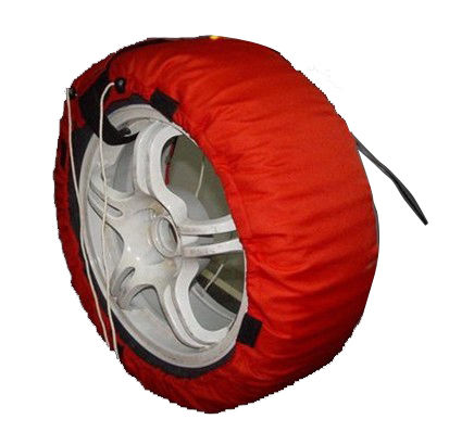

you guys need to step up your game so your ready to roll [img]<<GRAEMLIN_URL>>/beers.gif[/img]
