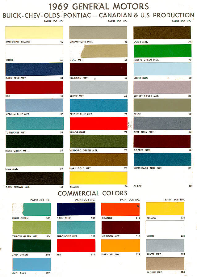

A buddy of mine is restoring a VERY worthy 1969 Chevelle and would like to compare paint samples with a car that still wears original Cortez Silver paint. Unfortunately we can't find an original unrestored car nearby, so I'm searching for a small part off an original Cortez Silver 1969 Camaro, Chevelle or Nova (like an original valence, header, cowl, spoiler etc.) that we can have shipped up here in order to match the paint samples to it. The part can be damaged and otherwise useless, as long as it still has a decent remaining sample of paint that can be cleaned and shined-up.
If you have a good sample item, please post a reply or send me a pm. Naturally, we'll pay for the item (if it has value) and the shipping costs.

If it helps,the 1969 Chevrolet dealer album has paint chips,as well as my 60"X40" 1969 dealer showroom paint chip & fabric sample board.
As well as Ditzler pages..Code 69 Silver Metallic

Thanks. I have those too, but those are really small samples to try and match up to... But thanks for posting.

For what it's worth.. Those pages of paint samples are ink, not paint. Color distortion can ensue over time with light exposure, etc. Most notable Corvette judges will not use them on the field.
