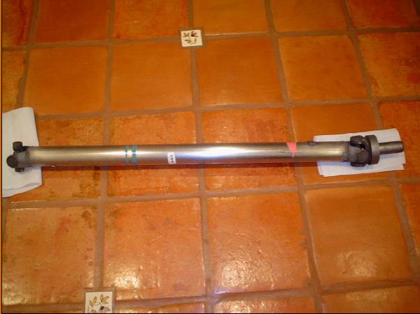

I have only used Evaporust. I have found a lot of paint markings that I would have never found. End of my axles were dingy so I set them in the bucket over night and this appeared.
Bill
