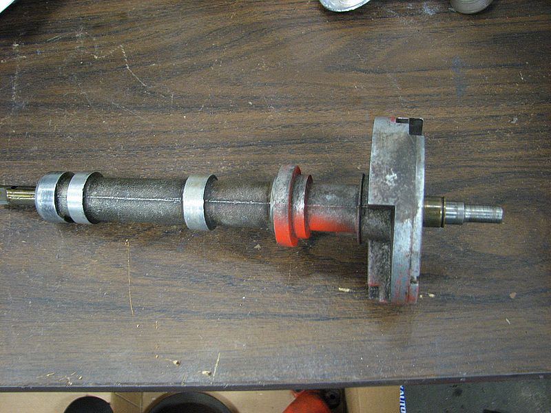

Do they make something that attaches to a drill that can spin the distributor shaft if it's already in the engine? Something where you could just remove the rotor and attach a device that would spin the shaft? I'm getting close to firing up the Deuce, and really don't feel like pulling the distributor to use the priming device.

Primer shafts only run the oil pump. You would have to turn the entire engine, because the cam gear is attached. I have primed engines with the coil disconnected and run the starter until oil pressure shows on the gauge

No way to do it with the distributor installed other than to remove the spark plugs and crank it over.
If you decide to buy/build a priming tool, it <span style="text-decoration: underline">must</span> have the part of the body that goes inside the block by the distributor gear--it's the round aluminum part with the groove in the middle on the right of this picture (This is the Crane priming tool). This is required as it completes the oil galley path at the back of the block. Without it (such as the Moroso unit in the 2nd pic), oil will not reach the top of the engine.

<div class="ubbcode-block"><div class="ubbcode-header">Originally Posted By: ds1</div><div class="ubbcode-body">Primer shafts only run the oil pump. You would have to turn the entire engine, because the cam gear is attached. I have primed engines with the coil disconnected and run the starter until oil pressure shows on the gauge </div></div>
You are right - didn't think about cam gear connected to the camshaft connected to the.... I guess I'm pulling the distributor afterall, what a pita.
