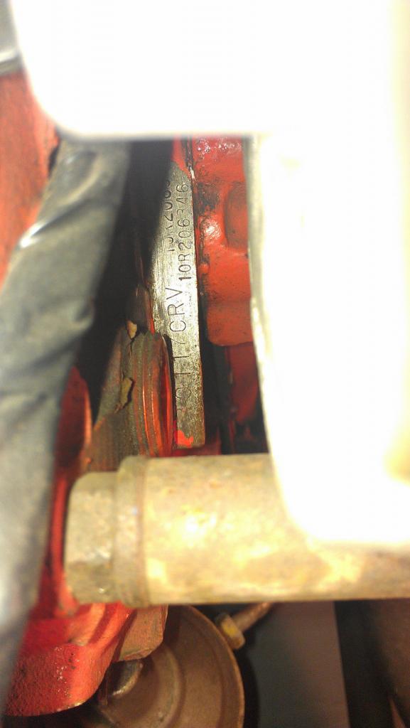

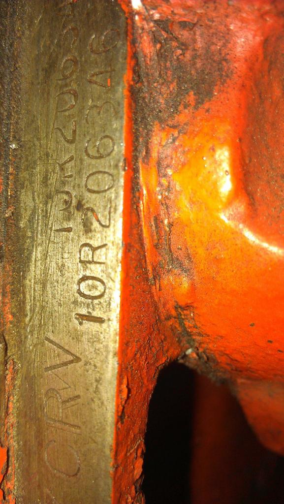

This is a Arlington Built LS6 Chevelle block. Would appreciate opinions of those in the know?

Looks OK to me.
Looks as though the first stamp was punched to lightly then the guy punched it a lot better the second time around. [img]<<GRAEMLIN_URL>>/biggthumpup.gif[/img]

This looks to be a possible factory grind-off and restamp. I've seen a few like this that were done at Tonawanda, when for some reason, they had to change the engine's designated usage.
