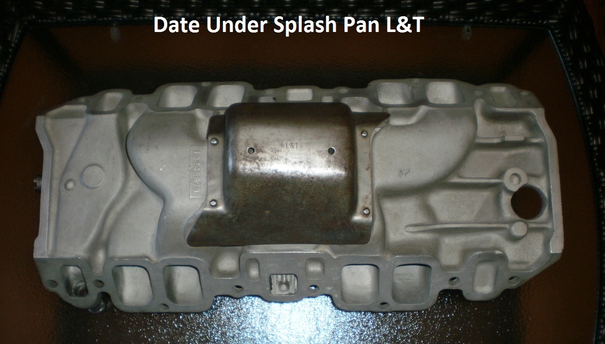

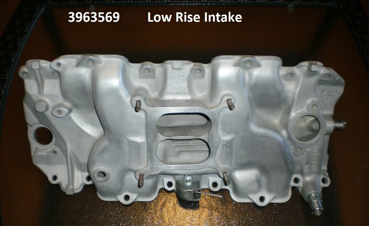

The Date code is under the shield. Here is a photo of mine before I put it on the engine.
I decided not to take the shield off mine to just check the date as I was confident it was original to my car anyways and did not want to re-rivet the shield back on. Once it's on the motor who will see the date anyways [img]<<GRAEMLIN_URL>>/biggthumpup.gif[/img]

The only issue with cleaning them is if you were to glass bead the intake -- trash may remain under the heat shield ... I have always (and very carefully) removed the rivets and and cleaned under the shield, then reassembled.
But there are other methods to clean ...

Sand blasting or glass beading without removing the shield is just inviting disaster. Sand is deadly to the whole engine.
