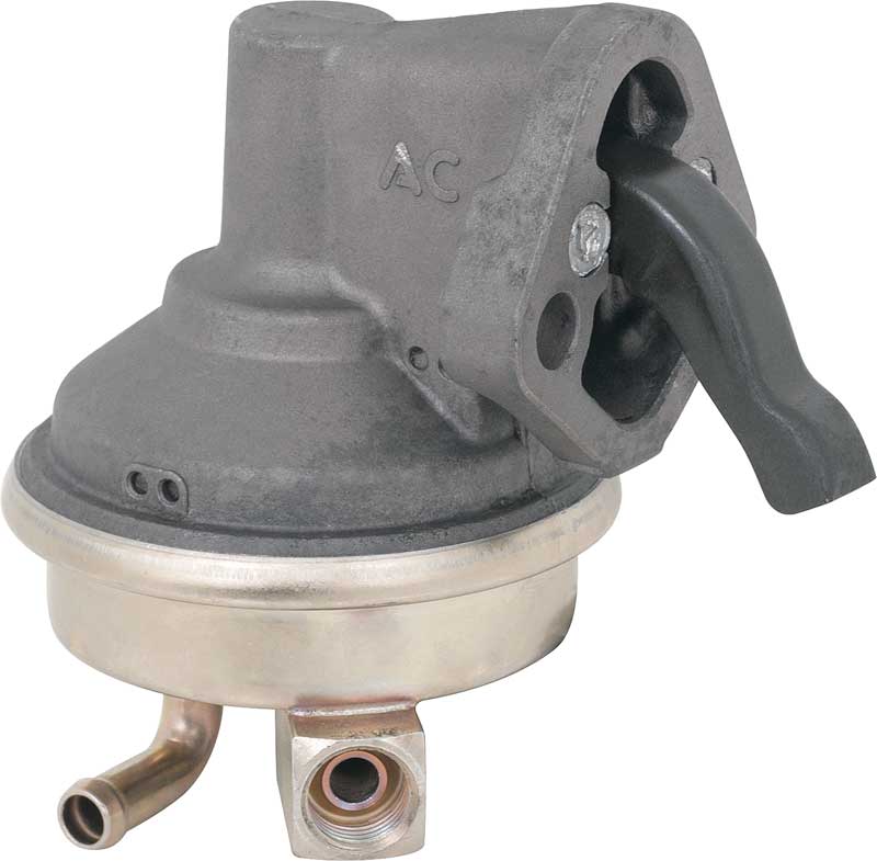

Anyone have pictures of an original pump? I bought one that was called rebuilt and I think it's a repop. Drain holes don't look right

if it has the big AC logo on it that would be good enough for me.

Make sure there's no circle around the AC logo.
Here's an original..

There seems to be some variation on which weep holes are open. Mine are toward back of car. Some are on front

Couldn't remember if it had a circle. Probably a reproduction. Nice the vendor does this

Yes,that photo you posted is a new world reproduction.
