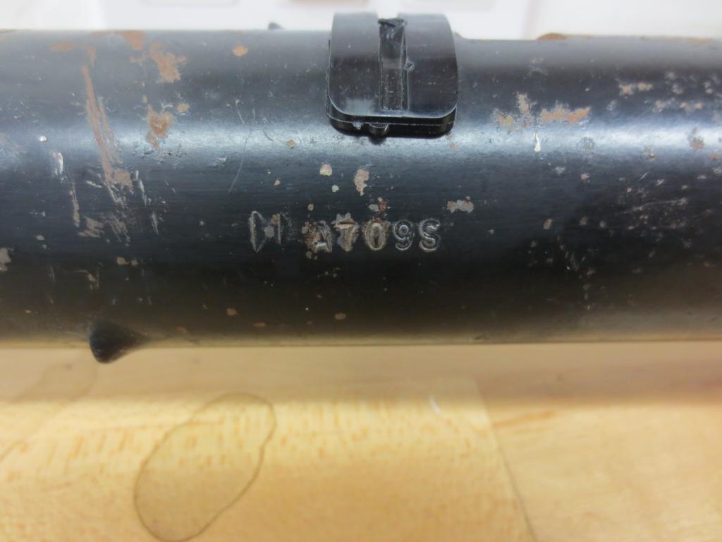

i bought a tilt column this weekend that is suppose to be from 69 Camaro -
the code on the bottom of the shaft housing is stamped A709S
the reverse lockout lever is correct - as well as the 2 levers for 69 style.
can anyone tell me what the date means ??

A=Shift.
70=Day of year assembled,March 11th.
9=Year assembled,1969.
S=Saginaw,Manufacturer.

Any chance on seeing a pic of the stamping?

Second that pic request also -- I have a column that supposedly came from a 69 Camaro ...

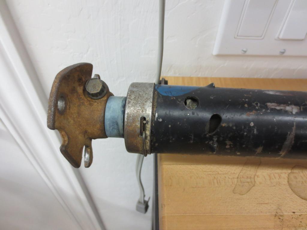

here u go guys

stamp is near the plastic mounting for the reverse light switch on the lower portion of the steering column
