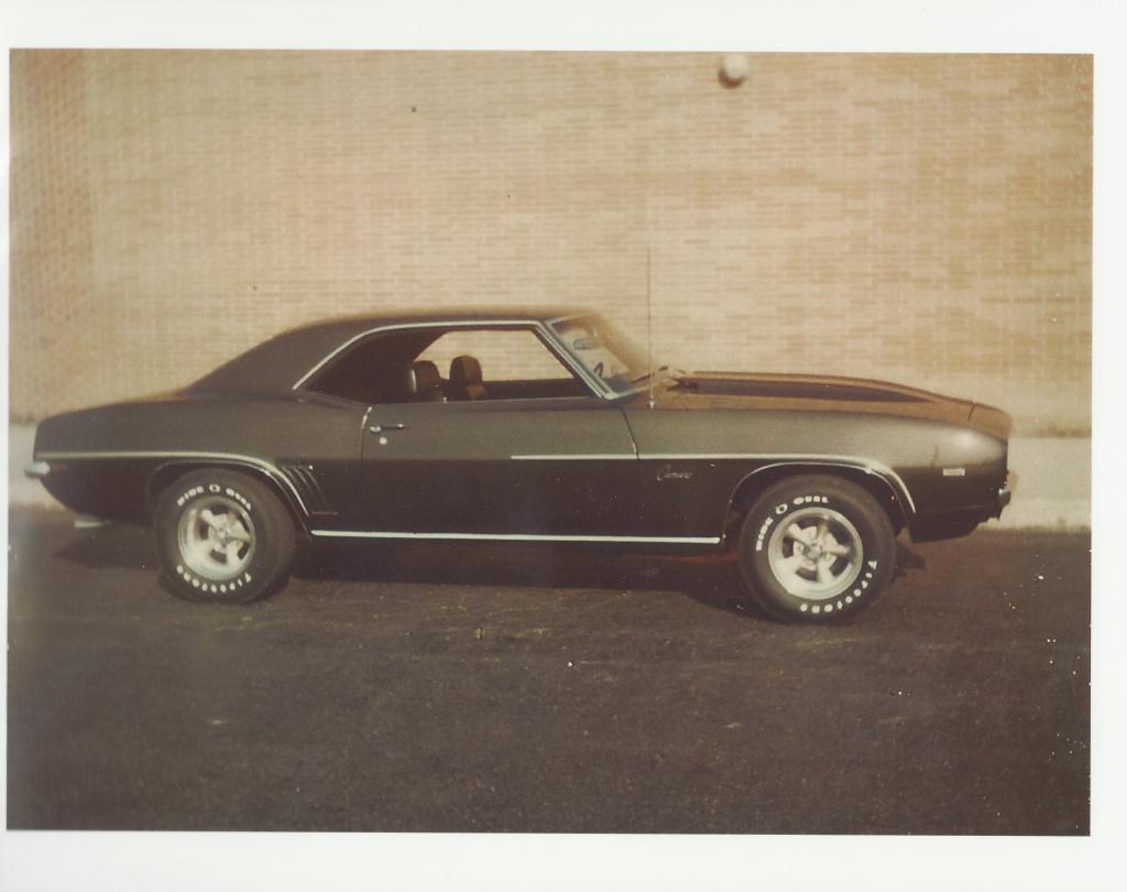

picture of my burnished brown RS COPO when new - Camaro emblem
