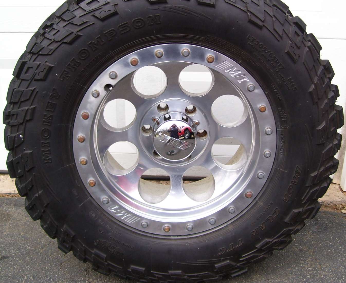

Would like to know if others have attempted to polish the aluminum wheel lips with fine sandpaper first, ie; 1500, 2500, then Wenol, then the 'soaked cloth' rubbing. Any downside to hitting it with 1500 grit first?

I usally start off with a polish, then work my way into the grits. I start high then keep getting more aggressive till I find what works. Then work my way back up. Everything seems to be a bit different depending on what you are starting with. Just remember, it's always better to progress to the coarse grit, the reverse just adds a bunch of work you may not need to do.

I see, that makes sense - perhaps I'll start with the 2500. I used 1500 the other night, it worked well - but it was a used piece of sandpaper, so it was probably more like 2500!

I had a set of vintage ET wheels gone over by a pro. His method was to start with a Scotch-Brite pad with polishing compound, then go to cloth. Shortens the job and works great. The Scotch-Brite doesn't clog up like sand paper would very quickly so you can keep going with one pad and just add polish.

Marlin -- also, you may try the 3M red pads ... TAZ

Marlin - gotta do them on a lathe if you want the faces perfectly flat. &quot;Polish This&quot; is not too far from you and does amazing work.

I hit them with some 2500, then rubbed them out pretty good. They will come around with some more elbow grease - I couldn't wait anymore, had to get them on the car! It took 6 years to find a matching pair of Appliance Mags for the back of my Deuce, old style with the pointed spokes, 7&quot; wide with a little more offset to the outside. Still running F70's, but the next set will be 60 series - it's a little tight around the fender lip....
Putting the Atlas Alloy 'Aa' decals on the centercaps....
