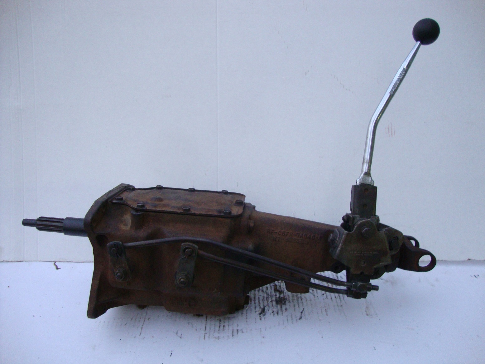

What 3 speed did Pontiac use in the 69 GTO? Thank you in advance. Tom.

The GTO 3 speed manual transmission was based on a Toploader Ford unit. Here is one I recently had.
