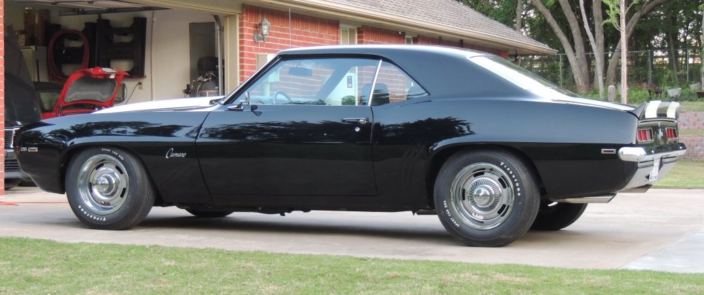

Replaced front coils on my 69 camaro last year with a set from heartbeat city #3955711-el. The car sits to low for what I would like. I have 14x7 torque thrust and they rub front fender. Any suggestions? I also replaced the rear at same time with the correct multi leaf. I like the rear and would like the front sitting correct. 1969 camaro v8 4 speed p/s p/b no a/c but is an rs. Thanks Eddie

Some good discussions on spring selection for a first gen camaro over at camaros.org.
Sounds like you need to raise it up more than a 1/2 inch. However, if you think 1/2 inch would do it for you, I would suggest a pair of these:
http://www.ebay.com/itm/1964-81-CHEVELLE...r#ht_2095wt_854
I have a pair in my car. Needed them to fine tune. I used a pair of springs out of a big block El Camino, then cut off either one or two coils (sorry, can't remember as i did that in 1977). I still have the original Z/28 springs, but they sit a little high for my taste. However, I can put them back in any time I want. That is why I cut up the El Camino springs.
The 3/8 spacer will take the overall height up about 1/2 inch.
If you need to go higher, I would suggest finding someone who has a car that sits how you like, and see what spring they used.

talk to the guys at eaton springs, tell them what you want to do and what height your looking for and they will make them for you....I did 3 sets for a 68Z, from several vendors including HBC and no one is sure what they are sending you....very frustrating event for me, eaton , one converstation and they nailed it.
nothing special, just stock ride height...how hard can that be?

You are correct, Sam, you would think this would be easy, but I have heard the same stories for 20 + years. And it isn't just getting the height correct. The height can be right, but the spring rate too soft, and it doesn't handle well at all.

Thanks guys I appreciate your abvice. I was lucky to be at the street rod nats this weekend here in town and talked to Eaton in person. They were very helpful. Hopefully second times a charme. Thanks Eddie

Bob Harris (Camaro Specialties) has springs for all four corners now, he guarantees the car will sit correctly if you provide him with the model and options.

I did the same thing bought 1969 Camaro hg springs for a 427 car.. from heart beat car sits on the ground

It looks like the front needs to be raised at least an inch, the rear looks pretty good
