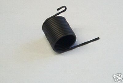

Carb is missing its secondary
Throttle return spring
I need one that will
Work for it......

Secondary throttle return spring? [img]<<GRAEMLIN_URL>>/hmmm.gif[/img]
Not sure what you're referring to there.

Guessing he means one of these.

That spring is for a mechanical secondary carb, there's no provisions to mount it on a vacuum secondary carb. Besides, if the carb is gear drive, the primary &amp; secondary throttle shafts are 1-1 so there should be no need for a secondary return spring. The secondary shaft should close via the gear drive as the primary side closes.

So the primary spring closes all three barrel for a leak-free seal.

Correct.

I dunno
The guy I bought it from
Told me it needed that spring
( like the one in the picture)
I have never owned a 3 barrel
Holley before ......
So doing this one is
All new to me ....
I remember these holleys
From the guys cars where I grew up
As a kid .....always wanted one ...
