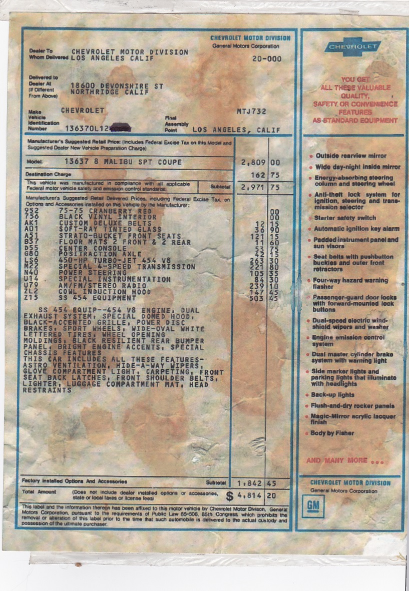

i purchased from a auction house which was advertised as an original LS6. The chevelle came with what was advertised as an original window sticker. I have had the car for a while and used it as a driver but have decided to sell it. I have not been able to locate a build sheet for it. I am hoping that someone here can tell me if this is a real window sticker. The pic shown is a copy of the one i have so the paper and size will be different. Thank you in advance

100% modern day reproduction & artificially aged.

What are the tattle tales?

First and foremost, a Van Nuys VIN starting in 12xxxx would have been manufactured far too early for any LS6. Also many of the fonts are incorrect as well as how things are abbreviated. Some symbols are also incorrect.

<div class="ubbcode-block"><div class="ubbcode-header">Originally Posted By: Mr70</div><div class="ubbcode-body">100% modern day reproduction &amp; artificially aged. </div></div>
X2 for sure.

Man, the people who do that kind of stuff should be smacked around and then prosecuted.

i like the tea bag stains. They cook tank stickers too. i would call a mouthpiece over that.

<div class="ubbcode-block"><div class="ubbcode-header">Originally Posted By: markinnaples</div><div class="ubbcode-body">Man, the people who do that kind of stuff should be smacked around and then prosecuted. </div></div>
Sad thing is a LOT of work has gone into locating these a&amp;&amp;wipes, finding proof of wrong doing and catching them red handed only to have the prosecutor and defense attorneys plea bargain it down to a much lessor charge and they go right back at it. &quot;douche&quot; comes to mind....
