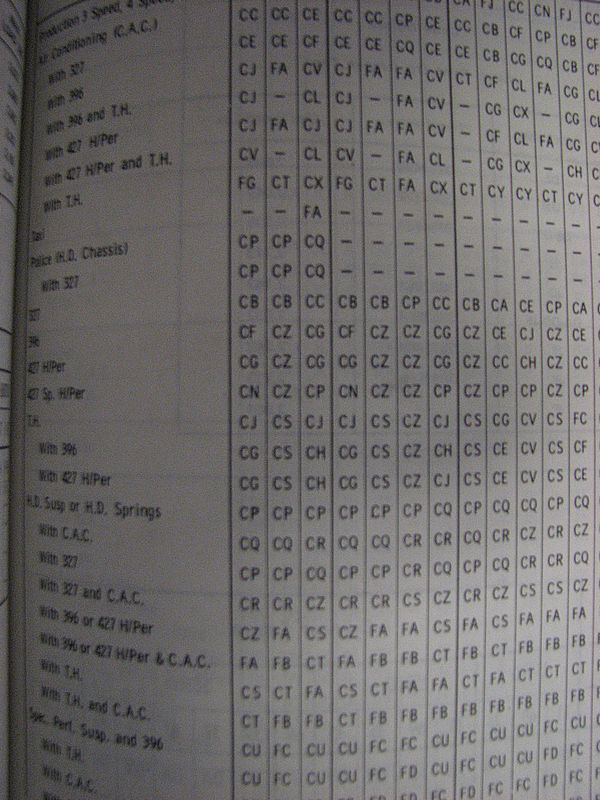

anyone find a good site to decode the 2 letter tags on coil springs?thanks

I need to decode what a 66 full size(biscayne/impala) front spring tag code cz translates to...I believe its for a 427 but cant find the chart...anybody [img]<<GRAEMLIN_URL>>/dunno.gif[/img]

CZ fits a variety of cars/engines, including 327, 396, 427 and sp hi perf 427. This comes right out of the GM parts book chart.

I would find it hard to believe that 327 and big block would call for the same coil spring would,nt u guys?I have dropped a big block in a small block car before and the front end dose a nose dive....My big block car has its orig tags on the front that say cz and iam just trying to confirm its pedegree by the small clues iam finding..thanks

Someone at Impala.net got back to me and said that the information you're looking for should be in the 1966 Assembly Manual. Hope that helps.
