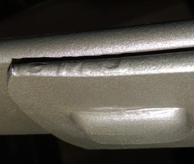

I realize I could have purchased some very correct looking rear springs, but want to use as much of the original old car as I can. Besides, these originals were not in bad shape, and they have that cool &quot;GMU&quot; embossing on the sides of some leafs. Even got one embossed area squeezed down where the leaf tapers.
