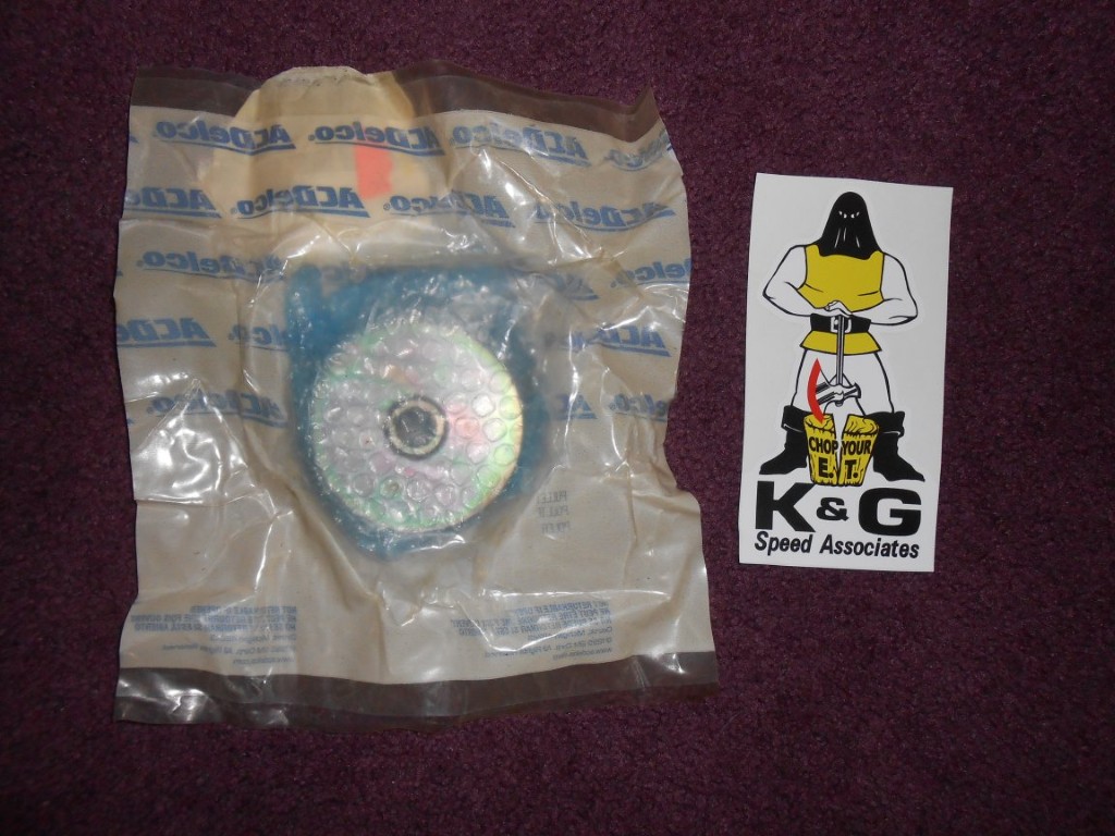

Old 10-24-2012, 12:16 AM
Plowman's Avatar
Plowman Plowman is offline
Join Date: Jun 2003
Location: Roslyn, PA
Posts: 1,704
Thanked 5 Times in 5 Posts
Default Re: '70 LT1 Alternator Pulley & Fan Finish
This is how GM was finishing them several years ago.
