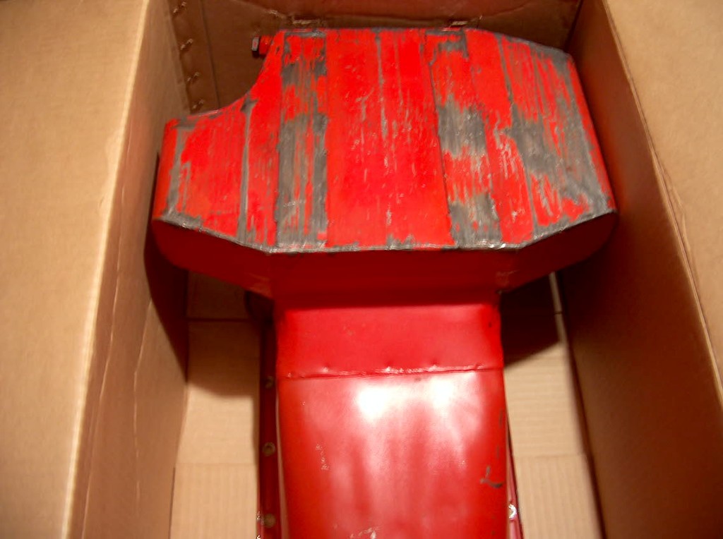

I may have just the pan for you. I believe three swinging doors to keep the pump pick up submerged. Stock depth, but extra wide for an extra few quarts of capacity. Had forgotten I even had it until I was moving last week (I hate moving).
If interested, let me know and I can send you some pics.

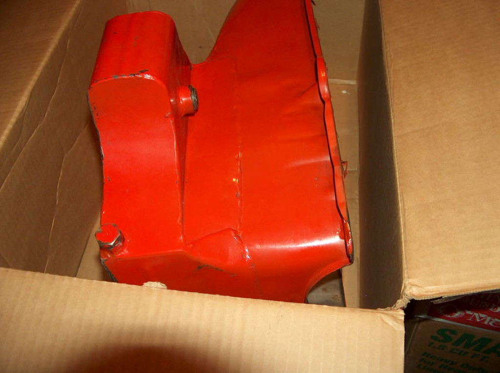

Or something like this if you are turning corners and don't want the extra deep sump:
